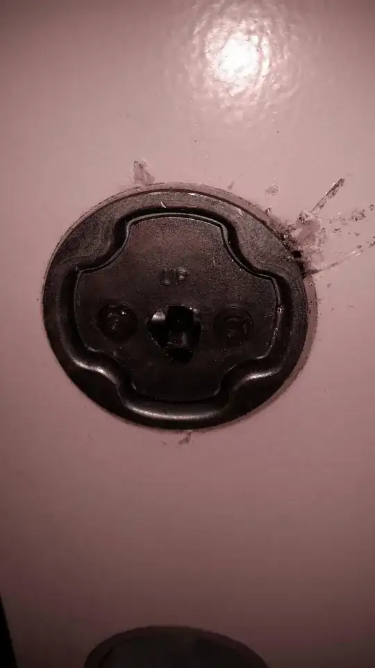

I'm removing an old Kwikset deadbolt circa 1995 I got the handle set part out but this deadbolt has some type of protective casing and the front is not coming off nor the back.
Here's the back side.

Looks like it is a double cylinder deadbolt (has key cylinder on both sides). Use a flathead screwdriver to remove the two black bolts.
