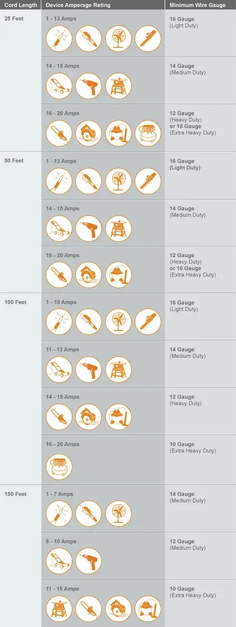

If you have to join two extension cords together (for a longer reach), make sure the cables are both the appropriate gauge to handle the extra length. To prevent the ends from coming partially or fully disconnected (which can be annoying, and a possible shock/fire hazard), tie a simple knot to hold the cables together.
Keep in mind that connecting too many cords together can be a fire hazard, and make sure you are using appropriately sized cables.
Here is a good table from Home Depot for determining the minimum wire gauge recommendations for different devices and cord lengths. Buying Guides: Extension Cords.
As an example if you want to use your circular saw at 100 ft., you'll need at least 12 AWG cable. If you need to reach an extra 50 ft. (150 ft. total) and happen to have an extra 50 ft. extension cord, both cords should be at least 10 AWG.
  • How do you determine what gauge is required for what length? – jrdioko Jul 15 '11 at 16:55
    @jrdioko: see edit. – Tester101 Jul 15 '11 at 17:10
    I don't like that knot, it puts too much sideways pressure on the cord end. ( Where it is likely to fail anyway ) [I prefer grabbing both ends and making a single large knot, far enough away from the connection to reduce the strain on the ends.](http://lifehacker.com/5833990/knot-your-extension-cords-like-a-carpenter-to-avoid-unwanted-unplugging) – Brad Gilbert Jul 02 '13 at 04:49
