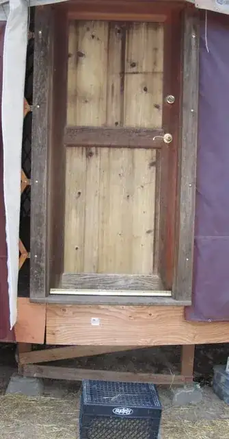

My yurt is up, but I need some steps.
The deck is 32" above grade. Eventually I'll build a landing / small deck, but I'm too busy with other projects right now (like closing in the yurt wall canvas!)
What can I do to put together some simple, temporary steps until I get around to doing it right?

  • Nothing to do with what you're asking, but is that gap between the joists under the hinge side of the door something to be concerned about? – Niall C. Jul 18 '11 at 04:53
  • @NiallC: Those aren't joists, those are 1'-wide strips of 3/8" plywood, bent around the perimeter of the round deck. The bottom edge flares outward slightly, leaving that unsightly gap. Later I may add cleats to pull them together, but only for appearance. – Jay Bazuzi Jul 18 '11 at 08:01
Jay, why not get a couple of precut stringers and 2X12 theads? Put a 1X riser on the front, a 1X nailer on the top back and screw it to the building. You can fancy it up later and use the same stringers.
