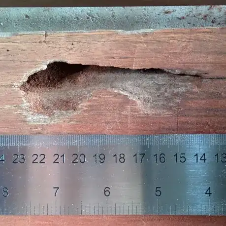

I got an old workbench with a top made by a pair of railway sleepers (I assume this is timber). It was very old and sticky with paint stains and not very plane at all, so I tried to use a router and a planning jig to make it nicer to use.
I've almost completed the process and it only needs a last router pass to be "almost as new" but it has a few big holes (about 10cm/4 inches long, see picture below) that I would like to try to fill to avoid them being always filled with sawdust or trapping screws and other small things that like disappearing in holes. I'm also concerned that since they are close to the edges the outer part may break away and make an even bigger hole.
Hole in workbench top
I heard about something called "liquid wood", but also of "epoxy glaze" and some peoples seems to use wood glue mixed with sawdust, but I have no idea which of those solutions (or another one) would be the best in this use case.
I don't want to have a "mirror finish" (this is a workbench, and I'm planning to use it) but I'd appreciate if it could still look good.

  • Which product can I use to fill those holes
  • Should I fill the holes before the last router pass or should I finish with the router and fill the holes later (then presumably sand whatever I put in the holes)

I would use a wood patch called a dutchman. If your router has a plunge feature, make a small template to aid in cutting in a dutchman. The article the link refers to does it differently than I do, since it cuts out the damage and the repair piece with the router using one template and two different guides. Where I use one guide only to cut the bad spot out, and a table saw or miter box, or sometimes both to cut the repair piece itself, depending on how big the repair is.
You would be able to get a dutchman in plane pretty easy with the surrounding material, but as with any repair of this nature, I would do it before the last pass of the router over the whole surface, then sand everything uniformly afterwards for the fine finish. This will clean up any glue mess from the install of the dutchman.

  • Thanks, I heard about this method but never find a detailed way to do it. I'm very tempted to give it a try; especially since from what I understood if it goes wrong I can make a slightly bigger template and try again; my only concern is those holes are very close to the edge of the board and I'm afraid using the router to enlarge the hole may break the outer edge. Also the holes are pretty deep. Can I put some epoxy glue in the bottom of the holes as suggested by ojait? I'll try to find one of those "router inlay kits". – LeFauve Nov 06 '15 at 23:24
  • Now that I know the proper name of this method, I found this video: https://www.youtube.com/watch?v=Ld6HI7g_U6Q . It sounds like what the article on dummies.com describes, however I noticed the issue with corners that of course cannot be made by a router bit; Wouldn't it be easier to use a "round rectangle shape", so there won't be any straight corner and the router will cut the perfect shape without any need of using a wood chisel? – LeFauve Nov 06 '15 at 23:41
  • The router does not need to be cut full depth of the recess. If you cut in 1/2" max, that will give enough surface for glue bonding and enough thickness for durability. The edge looks like it is about 1/2" away from the edge, cutting with in a 1/4" with a SHARP bit will work. I like the idea that the dummies book presents, with the 2 different size collars, you could make the patch the shape of an amoeba with limitations of course and the fit will still work. The idea was with the patch was to have round corners as it was, even if it is only a 1/8" radius. – Jack Nov 07 '15 at 07:04
If you don't mind not having the patch resemble the surrounding wood species; for a quick long lasting wood filler I've always used automotive body filler (Bondo). It is a two part product and once the hardener is mixed with the filler you have finite time to use it (depending on the amount of hardener used). Once cured it can be shaped with basic wood tools. The real benefit is it won't move (expand or contract), it isn't affected by climate (U.V. and rain-proof), and it's very inexpensive. The only possible down-side is it's color (pink to reddish) which can not be stained. It accepts any paint type readily. Another alternative that is extremely durable is to use any brand of 2 part epoxy glue. Since your wood surface will be subject to physical abuse, epoxy applied to any size holes can not be jarred loose. Also, it is liquid enough to be poured into the void to find it's own level and it will prevent any splits or cracks from further opening because of its strong mechanical bond. I believe you can find several finish/color types ranging from a clear 5 minute epoxy to the traditional grey color (I know there is a white color, too).

  • Thanks! I may go with the dutchman solution but the boards also have a few smaller drill holes for which the epoxy or bondo should be perfect. – LeFauve Nov 06 '15 at 23:28
  • There are bondo-like products that aren't grey or pink. If you're in the US, Minwax makes a 2 part "high performance wood filler" that's really just bondo in beige. But you'll enjoy the dutchmen that @jack suggested. (Shapes don't really matter, but personally, I find the bowtie to be the most snazzy, and all it takes is a little bit of chisel work.) – Aloysius Defenestrate Nov 07 '15 at 01:58
