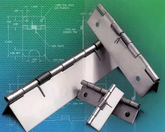

What about a magnetic door stop combined with a stay open spring hinge?
Such as this one from Home Hardware
Found on google image
Stephen
  • 1,925
    This requires you to open the door all the way so that it meets the magnet, though – endolith Jul 21 '11 at 20:50
    @endolith: If there is space in the frame, you can throw your door slightly out of plumb with a washer behind the hinge. Then when it's a little open, it will fall all the way open to the magnetic stop. – BMitch Jul 22 '11 at 13:17
  • Where do you find these hinges? I think everything I've found keeps the door closed, not open – endolith Aug 20 '11 at 15:37
    I think I originally googled for reverse spring hinge or stay open spring hinge. – Stephen Aug 20 '11 at 19:51
  • This seems like the best answer, so I'll accept it even though I haven't found the parts to implement it yet. She locked *herself* in the bathroom the other day, but nothing bad happened. – endolith Oct 26 '11 at 15:18
    I installed one of these on our bedroom door that had a habit of self-closing, and found it was really loud when it engaged. It also took quite a lot of force on the knob to break free, to the point that the door would visibly twist. We fixed both problems by sticking a little felt disc meant for furniture legs into the magnetic cup. Still plenty of pull to keep the door open but much quieter and easier to disengage. – Mike Powell Nov 29 '11 at 06:25
