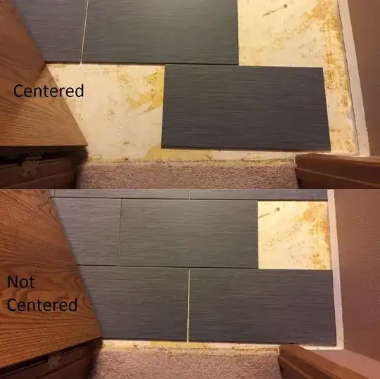

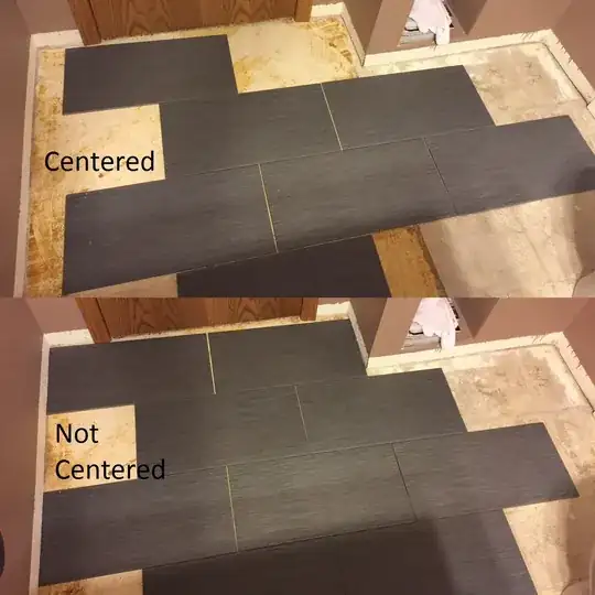

I am tiling a small bathroom ~45sq ft. The book I am referencing suggested starting the tile in the center of the room to prevent laying any tiny fractions of tile near one side of the room. I'm working with 12x24" tiles and it looks like I might be better suited with starting the tiles at the door threshold. Is the start at the middle idea just a guideline that I can go ahead and break?
Door area comparison
Overview comparison

Based on your pictures, I'd choose the "not centered" approach, since the visible far wall is decidedly not slivers that way, but that's purely an opinion call, not "right" or "wrong."

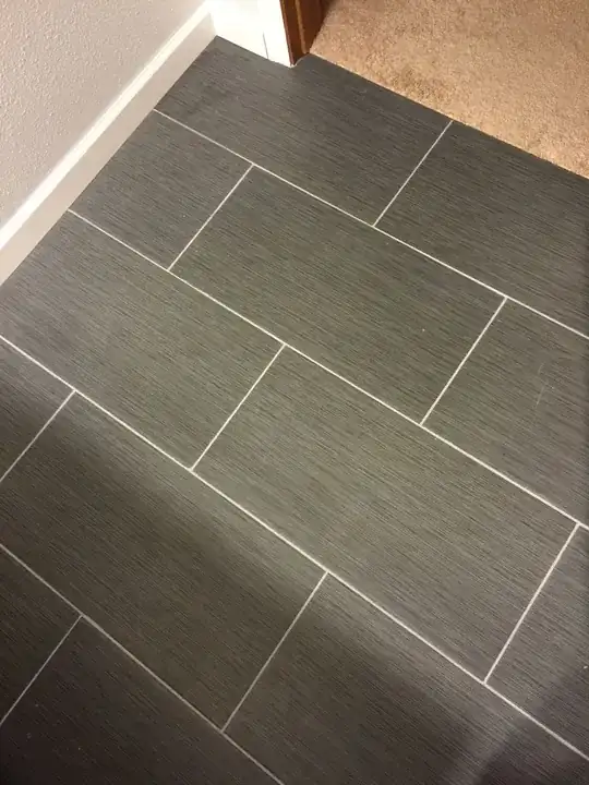

Yes, starting in the middle of the room can be a bit un-nerving. There's no reason not to begin in another location ; as long as you're comfortable with the appearance of cut tiles along the wall. For the sake of balance and uniformity It would be wise (as you noted) to begin at the most trafficked entry point working out and away into the room. I always found you get the best look from the tile if you can install full tiles to be in view when the door is open. So looking at photo #2 you see more full tiles and fewer cut tiles. This will also produce less work in that you won't be going back to the tile saw constantly and there won't be as much waste. You might want to trim the door molding so the tile can fit underneath rather than notching angled cuts. Keep your spacing along the wall as close to the joint spacing as possible if you don't intend to install wall molding (it will look neater). Any grout joint over 3/16 inches you will want to use sanded grout for a stronger grout joint.

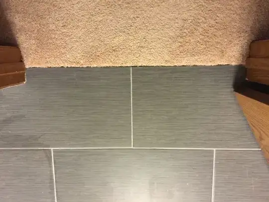

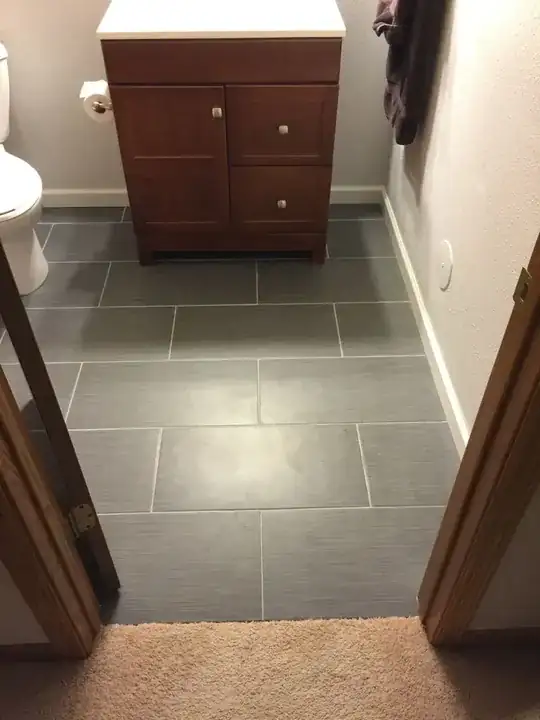

I followed the advice given here and went with the "non-centered" approach - to ensure that the threshold looked good and not start in the middle of the room. Here are the results:
Threshold The whole room Threshold corner Overview of entrance
