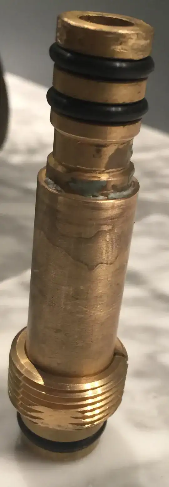

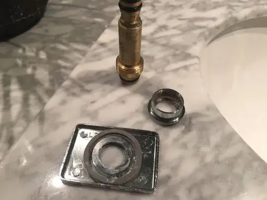

I have the piping in the wall, into which I think I push the adaptor, using the nipple to screw it in. That all pretty much works, then the face plate goes over it, and the spout goes onto the adaptor, using a little grub screw to sit in place.
However, whenever I try to screw in the nipple, I can't because it's recessed into the wall, behind the tile, and I have no idea how to actually screw it fully in.
What tool can I use? Can't use an internal/nipple wrench, because the adaptor is inside the nipple. Can't use a regular socket, none seem to fit around it properly.
Is there something specific to fit it?

Nipple - note flat sides Nipple and adaptor tube Hole Parts
Note, the chrome collar can screw to the nipple, but then it protrudes too much for the plate to sit flush on the wall, and it's too fat to go through the plate hole, so seems to just sit flush with it as a spacer.

  • Alex- how did you initially remove the stem from the wall? Also, the split nipple should be oriented on the stem such that the notches are facing out? – ojait Dec 07 '15 at 16:16
  • Yes, I noticed that - in actually trying to replace it, I've had it the other way around. Just put it together for a pic, and realised after I had it the wrong way around. – Alex Dec 08 '15 at 00:58
  • And, I was an idiot - took it apart so easily I can't remember how, and didn't document it. – Alex Dec 08 '15 at 00:59
So the adapter ring (the split threaded nipple) slips over the stem (the piece with the rubber O-rings). The stem is pushed into the supply pipe (in the wall). To connect the stem to the supply pipe the split threaded nipple is tightened until the stem is snug (the flat spots on the split nipple are there for a wrench). Next try sliding the chrome eschuteon plate on the stem and bring it to the wall. You should be able to fit the spout on to the stem and secure it to the wall plate.
