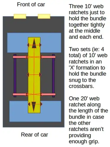

I think I'll have to do two trips. The planned setup is documented below (pardon the obscene number of pictures), and I plan to essentially run web ratchet straps (with band protectors where it comes in contact with the wood) to hold down the load to the cross-bars, and then an extra 20' web ratchet strap along the length of the load to act as a fail-safe. I'll have to drive maybe 20 minutes at highway speeds, and am concerned, especially in the case of the MDF board, of the payload catching too much wind drag and being pulled off the roof (ie: acting as a big parachute).
Does the setup below look sound? I'm not comfortable enough with my knot-tying skills to go with a hitch in place of the web ratchets, unless there are some dead easy knots I could use in place of the ratchets. I do not want to pose any risk at all to other drivers, so if I need to invest in additional hardware to secure the lumber, that's fine with me.

Second trip, 16 2"x4"x6' boards on my roof rack
3 ratchets for holding the bundle together, 4 in X patterns to secure it to the cross-bars, and a 20' ratchet along the length of the bundle as a fail-safe

24
You didn't mention how you're using the ratchet straps, but from your concern about slipping, I think it's possible that you could be using them to better advantage. So I apologize if this is what you're already planning to do, but just on the off chance it isn't...
For the MDF, you want the straps going over the edge of the MDF and running straight down to the load boar, so the force is all pulling straight downward. The way to do that is one strap per load bar, in a loop, with the joined hooks and the ratchet mechanism on the same side of the loop. In the following sophisticated CAD rendering, the Sharpie represents one load bar, the Post-It Notes represents one end of the MDF, and the rubber band represents the looped ratchet strap:
This approach will clamp a low, flat load very securely in place. With the straps snug you shouldn't be able to budge it at all. Nevertheless, stop to inspect the load carefully after five minutes and regularly thereafter, and you're right to worry about the parachute effect.
If you're not comfortable with what the load is doing on the highway, hit the hazards and slow down. If people can't pass, pull over every few minutes.
To make the loop, you join the hooks by putting each hook through the eye part of the opposing hook; under tension, that'll be secure:
That ought to work for the door too, but a glass door be a lot heavier than the MDF, and assuming the edges are plastic or aluminum or finished wood, it'll likely be smoother (i.e. less friction against the straps). Finally, it's a much longer drive. So I'd want at least one strap securing the front of the door to something under your front bumper, for insurance against sliding back under acceleration. And then another to the rear, to guard against hard braking.
I can't say for sure how you would secure those end straps without seeing the door. If the door is mounted in a frame, you could loop them around the lintel and sill parts of the frame. To avoid contact between the hook and the frame, tie a figure-8 loop in the strap two feet from the hook, run the hook end through the door frame, and hook it onto the loop. You may need a pair of extra long straps for that part. You'll need to keep the strap under tension for this to be secure, and remember that the rear one may be out of view so you'll have to get out and inspect it regularly. Also if the rear end of the door overhangs the rear bumper, as it probably will, then the rear strap can't resist forward movement except in a disaster where the whole door comes completely free. Then you're just hoping to slow it down a bit. So if a forward movement will slacken both end straps, you must keep a close watch on the front strap for slackening.
And here's how I'd put a strap around a bundle of 2x4s on top of the MDF. The loop clamps them together and also grabs them to prevent sliding back. Note that the loop is arranged so the strap crosses at the top, not the bottom. That method would work with sheet goods as well.

I think you're overthinking this. I carry all kinds of lumber on my roof rack all the time.
The 2x4s are no problem at all. Just strap them down tight, one at the front bar and one at the back bar.
Sheets goods are harder. Your drawing is completely not to scale and I think you will be surprised how big 4x8 is when you get it up there. However as long as your bars are wider than 4 ft it again won't be a problem.
I would do it all in one trip. In fact the 2x4s will help keep the MDF from flopping around. 2 or 3 straps should be enough.
