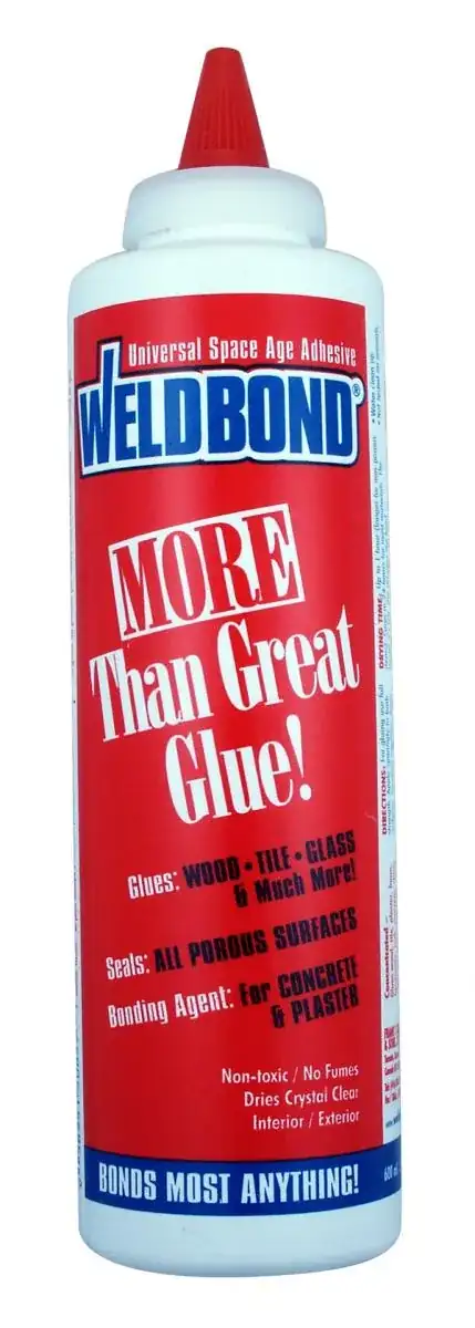

You could try brushing the edges with glue. I use Weldbond glue for similar purposes. You can dilute it, maybe a thin coat first to penetrate and seal, followed by a thicker coat to finish it. It's available in large sizes if you'll use a lot. Worst case it's a good glue so even if it doesn't work for your application, it will still be good to have around.
Weldbond
