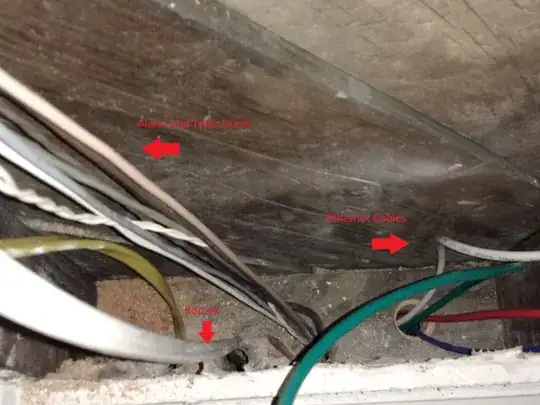

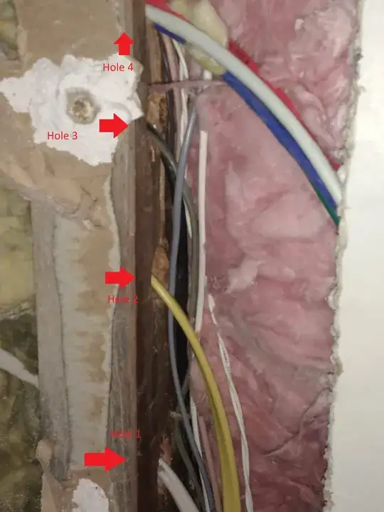

Here are some photos of the situation. I would just like to get some professional opinions on the matter. Pictures:
From the basement: Coming from the Basement
Passing over a stud: (this happens due to the fact that the wires run behind a closet on the second floor. I could technically bypass this and go straight up but I'd possibly have to knock down more drywall on the second floor. ) Crossing over a stud
Going up to the second floor: (the network cables just "float" past the header joist and do not go through it at all) Going up to the second floor
At the end of the day, I will have a total of SIX Romex Cables, One for the front two second floor bedrooms, one for the back two bedrooms, one for the front attic renovation room, one for the back attic room, and two 12 gauge for HVAC unit and appliances (in the attic renovation))

Well, your pictures have twigged an occasional issue I run into where I can't see them, (likely not your fault) but flying blind....
From a functional point of view you really don't have to worry about separation. Twisted pair is actually quite good at ignoring noise, and 60 Hz noise is of little note to 100MHz ethernet anyway. You can do it all wrong and it will work, 99% of the time. I don't suggest that you do it all wrong, I do suggest that you don't freak out about it.
From a code (and safety) point of view you should not have low and line voltage going through the same hole, and from a hyper-cautious network standpoint they should be separated by a good 12" when parallel, or cross at 90 degrees if they need to cross. Separation matters a lot more in an industrial environment with noisy devices on the powerlines than in a typical single-family residence.
From a "best practices" point of view, network and power in separate stud bays (when running vertical) or between different sets of joists when running parallel to the joists is certainly a best practice, though not required by code - it maintains separation quite aggressively.
Notches are far worse than "holes in the center third" (top to bottom) of a beam, joist, or header. Holes should not be too close to the ends, even in that center third. I'm not sure there's any need for the cables to go through the header if they can "float by" (remember, I'm flying blind here)
Portable electric heaters are nasty, nasty loads. If you are plugging one into a 15 amp (14 Ga) circuit that, all by itself, with nothing else on, is loading the circuit very near to maximum (if it's a 1500w heater, actually more than is permitted for fixed/hardwired loads that might (as with a heater) be on for more than 3 hours. A warm wire is fully expected under those conditions. A 20 amp (12Ga) circuit would be more appropriate if you are in the habit of using one.

    If you install the cable properly you shouldn't have any issues. However the NEC requires a 2 in spacing in Article 800.(A)(2) Other Applications. Communications wires and cables shall be separated at least 50 mm (2 in.) from conductors of any electric light, power, Class 1, non–power-limited fire alarm, or medium-power network-powered broadband com-munications circuits – ArchonOSX Dec 18 '15 at 21:33
