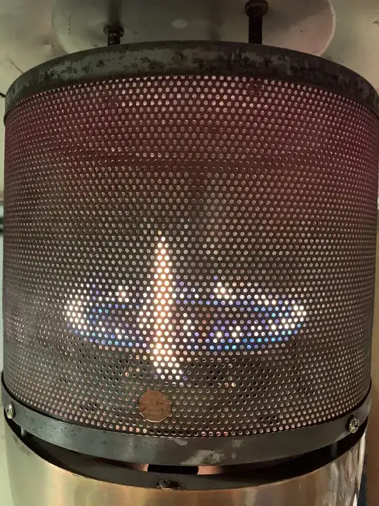

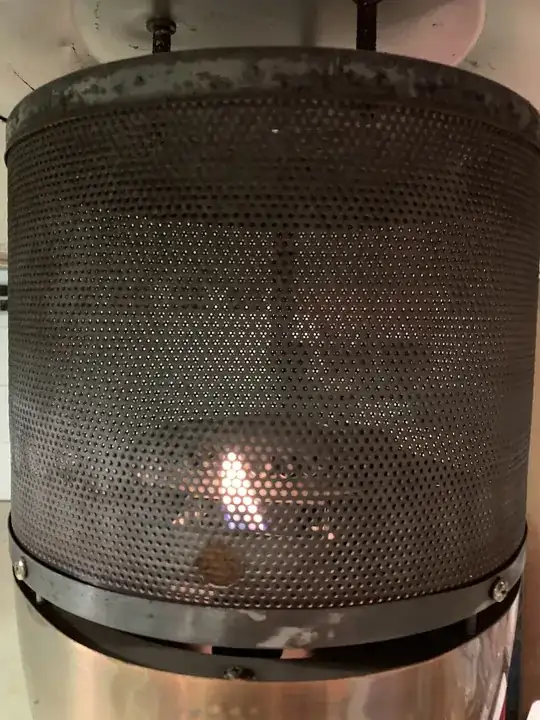

Flame stays blue the entire time, and on low setting, the tips are orange. The pilot flame is mostly orange now. See photos below. Not sure if that's normal, but the unit seems to be staying lit now and properly operational. I have not fully tested it on colder days so I will update this if needed. Tested in the 30's, and it still seems to work good.
Pilot:
pilot
Low:
low
High:
high
