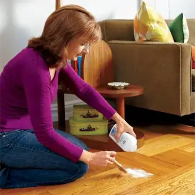

For a temporary fix, use some talcum powder. Work the powder into the joints between boards with a paintbrush and sweep away any excess.
http://www.thisoldhouse.com/toh/photos/0,,20447746_20886389,00.html ThisOldHouse.com

    Please add a little more detail here, like where you use the talcum powder, how you apply it etc. – Niall C. Mar 22 '13 at 22:34
