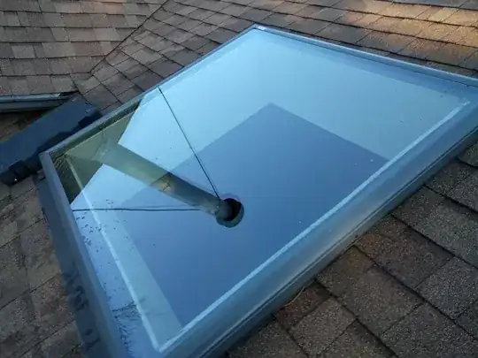

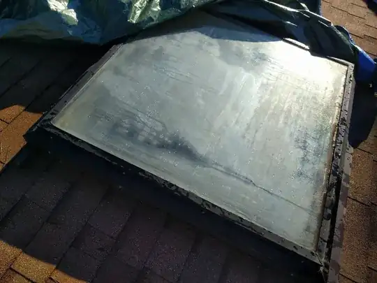

EDIT: I did the work. Here's the followup.
This is before:
old skylight
After:
new skylight
From the inside:
view from the inside
  1. I unscrewed the old one - noting that there were 2-3 screw holes that didn't have screws, and that there were 3 different types of screws that were used.
  2. I Inspected the curb and flashing, making sure it looked sound. It did. I couldn't see any flaws.
  3. I placed a little roofer's caulk in the old screw holes (not sure it was needed, but figured it couldn't hurt).
  4. I placed the new skylight over the existing curb and flashing.
  5. I screwed in the new skylight using the screws that came with it - pressing down on the frame while doing so.
Time will tell but I think it works.
