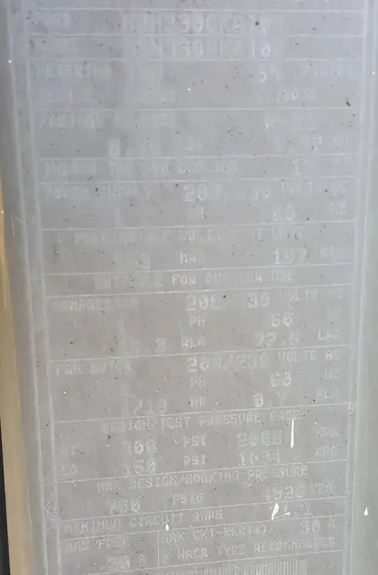

The system is relatively new and was installed in early 2010. We have two heat pumps, I'll include their labeling below, a gas furnace that doubles as the air handler in the basement, and an air handler up in the attic. The hard to read heat pump label (N2H330GKA100.. I think a 2.5 ton unit by that?) is for the first floor and is connected to the gas furnace. The other heat pump (N4H324AKA300.. 2 ton unit?) is connected to the air handler in the attic and controls the second floor. There are two thermostats, one on each floor that control just the units for that floor. They are programmable Honeywell t-stats. They look like this model, but they aren't WIFI enabled: http://author-yourhome.honeywell.com/en/products/thermostat/wi-fi-7-day-programmable-touch-rth8580wf?_ga=1.84873169.998057547.1452098258

Upstairs small heat pump Downstairs large heat pump
