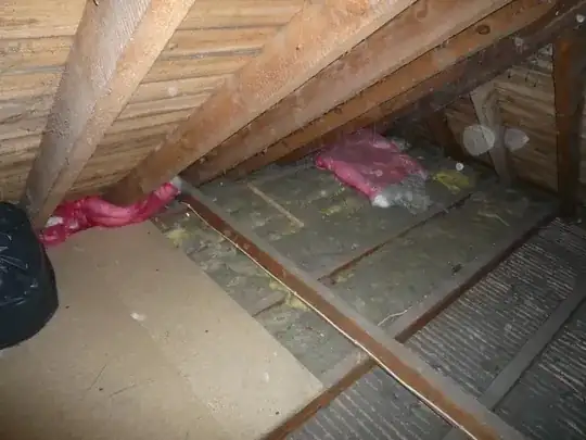

Next up, photo of one of the corners, bottom right corner on the floor plan, taken from near the hatch:
You can see the 4x2 ceiling joists and another 4x2 going left to right (ceiling binder?) that appears to be nailed to the bottom of the roof rafter and then sits up against the chimney breast on the opposed side of the loft (semi detached house) but not actually tied into anything.

Running parallel to the existing ceiling joists is the easiest and preferred way to go.
Removing the binders "locally" to allow the new floor joists to pass is "normally" considered acceptable (then connecting/pinning them back to the new joists passing through), though you would want to check such a detail with your local Building Authority before doing so.
Otherwise if you go the other way (perpendicular), you end up going above the existing ceiling joists, which causes a major re-work of the existing wall plate area that sits on the exterior wall and the roof area above.
