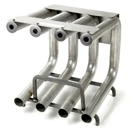

***UPDATE***I have researched passive fireplace air heaters.enter image description here The pipes are configured in a "C" shape. There are between 4-6 pipes joined side-by-side at the top and bottom with plates. The wood and than fire is built in the crook of the pipes. When placed correctly the lower openings pull in the rooms cool air were it is heated from the fire. It re-enters the room from the top pipe opening.
If you notice the thin pipe walls in the photo I don't see this product lasting more than a few fires before the fire degrades the metal. To me, the pipes in the photo appear to be similar to fence posts from a chain link fence or automotive muffler pipe.
I'm planning a build that would follow this design and would like to know what weld-able (arc or MIG) or braze-able pipe material would be the most durable? Durable as far as being able to withstand being heated for several hours without the pipe walls decaying?

  • @Mazura-added a photo of what I'm building. – ojait Jan 16 '16 at 16:37
  • Or maybe schedule 80 steel pipe? The thicker the pipe wall the better as long as I can weld it to the shape of the fireplace interior. – ojait Jan 16 '16 at 16:50

Just go with car or truck exhaust pipe from the auto parts store. It'll be the cheapest & weld great. I'd even go with top & bottom C's as your back, top & bottom cross-member mountings & stands to really optimize efficiency.

    @ojait - If I had to build what's in your picture; this. – Mazura Jan 17 '16 at 17:48
  • Yeah, the pic that came after my answer is pretty close to what I was thinking. But, I'd probably go with another large C for it to sit on that wraps under the back & then a front C as the log holder...ends 90'd out to the front. I'd also do the same bottom big C on the top, though smaller diameter pipe. I understand the natural convection updraft, but heat will still be directed away from the chimney draw...hopefully enough to actually get blown into the room instead of just radiating. – Iggy Jan 17 '16 at 18:48
  • @Manzura- what does your last comment above supposed to mean? Whats "this" ? – ojait Jan 18 '16 at 23:30
  • Sorry. I received & replied to him & now you, since the @'s don't do anything, on what I thought he was asking. What I might weld it up if I were you. – Iggy Jan 18 '16 at 23:37
  • @ojait - THIS. As in, *I'd go with this.* (I'd go with Iggy's suggestion: use muffler pipe) – Mazura Jan 20 '16 at 01:27
  • @Mazura- It's not thick enough (muffler pipe). The walls are to thin and will degrade after a few fires. Schedule 40 pipe as a minimum. Schedule 80 is better. (Sorry. I misspelled your name in above comment.) – ojait Jan 20 '16 at 02:52
