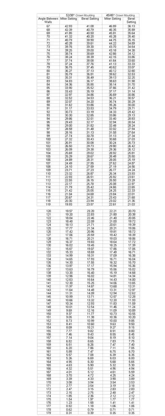

You could pick up a Bosch Miterfinder™ Digital Protractor
Features
  • Anglefinder — Determines the exact angles of jobsite or workpiece, eliminating guesswork.
  • Compound Cut Calculator — Automatically determines the exact miter and bevel settings necessary to make each crown molding cut fit precisely.
  • Protractor — precisely positions the workpiece or intended cut line at the desired angle
  • Level — Built-in vertical and horizontal spirit levels, accurate to 0 +/- 0.05°
  • Digital readout displays on front and back — For easier use
  • Hold Function - To freeze measurements
It will calculate the angles you need based on the actual angle of the corner, so you won't have to guess. You might not get a perfect fit every time, but you'll be very close so there will be less of an adjustment to make.
Miter-Bevel Settings Chart - Attached Below

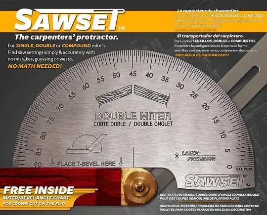

Hey I found a great tool that gives you the exact miter saw settings for cutting crown cut on the flat or up against the fence. Check it out its called the sawset here's the amazon link, works for other trim work too.
