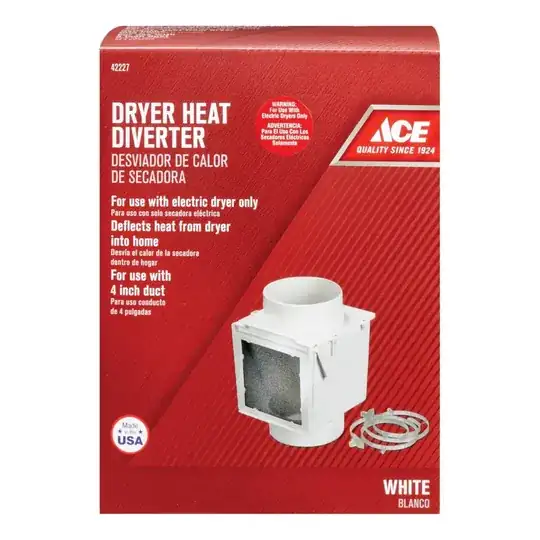

You can use a Dryer Heat Diverter: dryer heat diverter I've used one for 30 years; in the summer you vent the dryer to the outside, and in the winter you vent it to the space to be heated. For a large garage, the extra humidity in winter won't make a difference.
You get about 10k BTUs per run.

  • This looks like something I could use; I live in New England, and we have to run the basement heater zone in the winter to ensure pipes don't freeze... recapturing even a little of that dryer heat could stand to help me save on heating costs. – Doktor J Jun 30 '17 at 14:14
