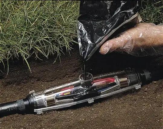

If you are running high voltage (110AC/240AC)
single phase then using a resin joiner is recommended!
You might be tempted to do something like this (this example is of low voltage coax,tv,internet, etc) and is not recommended for outside situations at all! over time water will get in.
That was undergorund application,
you can also use these above ground,
Notice the rubber seals- that is very important!
