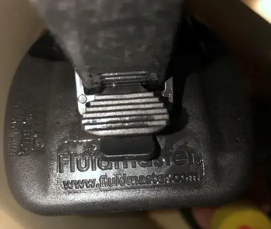

I just took apart the valve inside of my toilet to fix a crack in the floater. It's a Fluidmaster 300:
Fluidmaster 300
When I put the thing back together and turn the water back on, no water comes out of the refill tube. Instead, it squirts out of the top of the red cap where the black floater connects.
Underneath that red cap is a rubber diaphram, which i've pulled out and inspected. It's in good shape. it has a little nipple in the middle where a tiny stream of water can come out, and water is coming out of that, but not the refill tube. Anyone know what's going on here?
Edit: I found a little pin in the bottom of the toilet. Is this supposed to go in the nipple of the seal? Looking at the valve, I can't even understand how the arm raising could possibly shut anything off! I feel like I just discovered a glitch in the matrix or something.

The pin should be your problem. You're right, it does go behind the diaphragm, See this video at 58-seconds & 1:30 for an example, & inside the center of the cap.

I guess you have resolved this YEARS ago, but since I spend hours even trying to find this part (fluidmaster does not show the part on their page).
Yes, there are a locking piece you are missing there, attaching image of mine ... unfortunately I was trying to adjust mine, and after 'releasing' the lock, I cannot figure out how to lock it again ...
I take this will mainly be useful for other people in the future with the same issue. The piece is going under the pin, and somehow will lock it in place (I might end up trying to figure out on a second toilet), but first see if I can find instruction for how this clip is supposed to work.
The part is the small horizontal part under the long vertical piece.
Close up of floater
