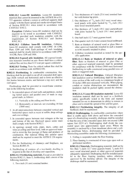

Blocking is required wherever a fire or draft can pass from horizontal plane to a vertical plane or vice versa. In otherwords, where the wall meets the floor and the floor meets a ceiling. If fire can pass through one section and travel to another, it needs to be blocked. The 2012 IRC code says that a 16" section of fiberglass insulation will suffice as fireblocking. If you are insulating the outside walls as it is, you will be covered.
Code book page

  • If I recall, for fiberglass insulation to be used as fireblocking it has to be unfaced. – Comintern Feb 04 '16 at 04:57
  • That may be so. My memory does not serve me that well all the time, so I will temper what I write next with that. I remember elsewhere in the code, if the insulation is in a confined space, like a stud bay, and not to close off a soffit, the facing is acceptable. I will check to see if I can find it in the exceptions and post it. – Jack Feb 04 '16 at 16:25
  • I found it, see edit – Jack Feb 04 '16 at 16:36
