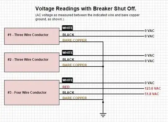

And here are the voltage readings, breaker #23 OFF, duplex socket removed.Voltage Readings
So what's going on here?
  • How is it possible that two circuit breakers are required to be shut off to access a single junction box?
  • Is that even to code?
  • What in a home generates a 51 VAC reading?
  • Why am I seeing voltage on the four conductor line?
  • In fact, why is there a four conductor wire in this box in the first place?
  • I have no clue what's going on here. Any ideas?

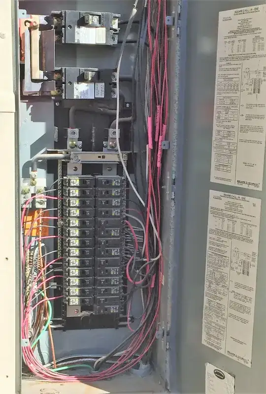

Somebody did take the time to mark each of the red/black pairs inside the box (note the pink sleeves on the right hand side of the box.) They also took time to ensure the pairs are adjacent in the breaker box. That helps a little.

    I suspect the black is on one breaker, and the red on another. They share the neutral. This is called a Multiwire branch circuit. With one breaker off, and the other on, you will get a induction reading 51.8 volts. – Kris Feb 10 '16 at 03:16
  • Code-wise both the black and red need to both be on one double pole breaker. – Kris Feb 10 '16 at 03:18

  • The picture of your main panel helps mainly to confirm that the wiring in your house is weird. But does this mean you've found the breaker to shut off the red wire? If so, then it seems likely that cable 3 is the supply wire, running power from your panel on two circuits, and cables 1 and 2 branch off to feed other fixtures. – Shimon Rura Feb 10 '16 at 19:48
  • Are those breakers QO or Homeline (HOM) btw? – ThreePhaseEel Feb 11 '16 at 02:38
  • Definitely Homeline snap-in – Kris Feb 11 '16 at 11:38

Second, what you have is indeed a Multi-Wire Branch Circuit (MWBC) -- the 52V on the black wire with breaker #23 OFF is stray capacitive coupling from the still-live red wire. The red wire, of course, is still live because of another Code violation, this time of 210.4(B):
(B) Disconnecting Means. Each multiwire branch circuit shall be provided with a means that will simultaneously disconnect all ungrounded conductors at the point where the branch circuit originates.
So, it's time to find the breaker that turns off that darn red wire (leave #23 off while you do this!). Hopefully it will be adjacent to Breaker #23 -- in that case, you can get a handle-tie from the electrical supply house and handle-tie the two dodgy breakers together to fix the issue as per 240.15(B)(1). If the builder was as clueless as I fear though, that breaker is somewhere totally else in the panel -- something you'll want an electrician to fix.

  • NOTE: If you're comfortable doing so, taking the cover off the panel should make finding the other breaker easy (assuming the 3 wire cable comes all the way back to the panel). – Tester101 Feb 10 '16 at 13:32
  • @ThreePhase, not that I'm a grammar expert, but I would not use the word adjacent when describing the location of the other breaker. To me adjacent implies left or right, AS well as top or bottom. It's too ambiguous. Why not simply say top/bottom. Though, it is possible the breaker could very well be left or right, but done correctly it should be over or under the current breaker. – Kris Feb 11 '16 at 11:45
