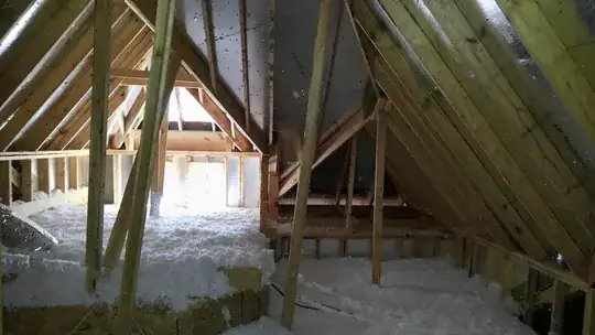

I am looking to add plywood flooring in my attic for storage page. There is a lot of space, very large areas. From what I've been reading, it looks to be ill-advised to add flooring if the roof was constructed with trusses instead of rafters (one such site). I have no idea what these are. Would someone be able to explain what these are and if my home has it.
Here's an overview: Overview image of attic
Other pictures are here.
Also I am aware that I would need to extend the floor joists keep the insulation intact.

    I believe someone needs to examine the construction and condition of your house to answer this. – keshlam Feb 10 '16 at 17:20
    Those aren't trusses...though I have *no idea* what those random angled posts are. In fact...I'm kind of worried about those. Those seem to be some sort of ad-hoc attempt at supporting ridges that weren't engineered properly. That said, given that they aren't trusses, you should be OK assuming your ceiling joists are large enough. Realize, however, that that will greatly reduce the amount of blown-in-insulation that can rest there. So it may not be a benefit in the long run. – DA01 Feb 10 '16 at 17:40
  • The type of roof would really not matter compared to the support of the ceiling (new floor). My shop is trussed 36' clear and one of my bays is 2 stories. The ceiling first floor, floor of the 2nd floor is 14” LVL I beams on 16” centers. This can hold several hundred pounds per square foot. If you have 2X4 or even 2X6 With the span of a room you may not be able to put much more than the sheeting up there without doing damage. This is what you really need to be looking at. – Ed Beal Feb 10 '16 at 18:11
  • This is totally dependent on the size of the joists which are covered by insulation. While the pictures of the oddly place supports and such are great (because they do make me feel better about my house construction) they don't really matter. Although I would like to kick one and see what happens. – DMoore Feb 10 '16 at 18:48

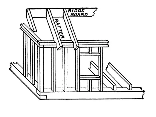

This is "Ridge board and rafters":

From your pictures, you clearly have ridge boards with rafters coming off of them.
The reason trusses shouldn't hold the weight of flooring or heavy boxes is because they are typically made from relatively small boards (2x4's in some cases) and the bottom board is already carrying a significant roof load because of the design of the angled elements.
