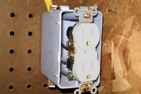

Most electric receptacles are installed into the box with long screws that have a special backing washer. The washer is there to hold out the receptacle, so you can loosen the screws until your receptacle is flush with the outer surface of the wall. The face plate is then fastened to the receptacle. In the US, the screws from the receptacle to box are at the top and bottom of the box (or left and right if mounted horizontally) and the faceplate attaches in the center for a typical outlet, and at top & bottom for switches, GFCI outlets, and many newer-style outlets and switches.
If you can get enough extra distance out of those, then you can tile right up to the edge of the electrical box. Here's an example of an outlet that has been set to protrude a bit outside the box:
proud electrical outlet
Note that you should tile around the edge of the box - don't tile right up to the edges of the receptacle within. This way the receptacle can be accessed if needed. The faceplate will cover past the edges of the box.

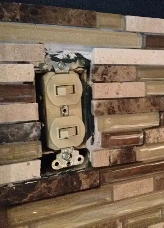

We opted for longer screws.
When we decided to tile our kitchen, we made these decisions along the way. We're both creatives and are usually adept with making educated guesses that turn out beautiful in the end.
Our inexperience tiling on a vertical surface (with outlets) resulted with the jagged edges around the box. Thus, we created our own switch plates. I made them larger to hide the imperfections and the result is stunning. enter image description hereFinal Result
Lisa
    how did you make that? That looks amazing. – DrewJordan Feb 23 '16 at 20:31
  • @drewjordan google "oversized faceplate". You can buy them in comically large sizes for people like me who can't drywall/tile worth a damn but try anyways. I've seen some that are about 8" tall. – Grant Feb 24 '16 at 04:10
  • @Grant thanks, I have seen those before but she said she *made* that one. It looks like maybe a big glass tile that they cut the center out of or something. – DrewJordan Feb 24 '16 at 13:20
