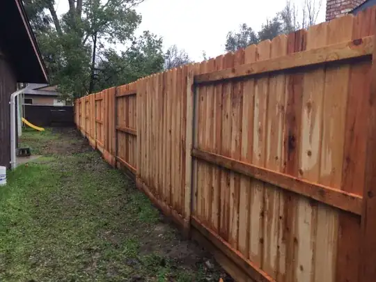

This fence was built with angled boards. The guy who did it said that would help with wind resistance. The fence is about 90 feet long, and the part of it down the fence line gets hit pretty hard when there are heavy winds. (The area closer to the camera in the first pic is sheltered more because of the houses.)

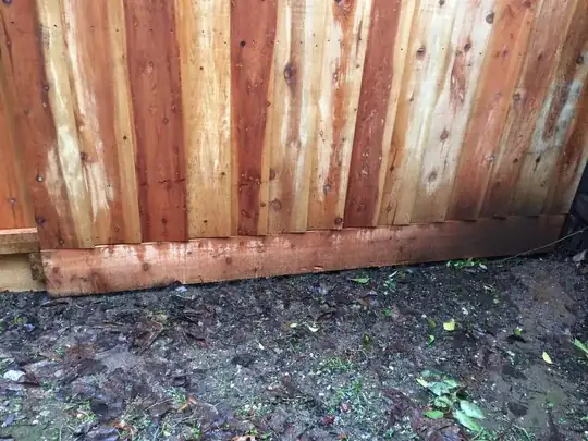

The second image shows how the boards were angled. The fence is about 7 feet tall.
The posts are metal.
Will this style of fence help with wind resistance? I'm not sure how angled boards, versus boards that are side by side, will make much of a difference, since the wind will be pushing against the fence no matter what. There are no gaps to allow air through.
Edited because someone said in the comments that it looked like he was building a shiplap fence, but after looking up shiplap fences online, it doesn't seem like it was a correctly built one. This Imgur album shows how the boards were put on. They're not wedge-shaped, and they weren't made to fit together -- they're basic fence boards that you would normally put flat against the rails.

    I don’t see how lapping the boards would make any difference at all since there are no air gaps. I have not seen this done before and would think it would cause the boards to cup more than the ones that are nailed flat edge to edge. – Ed Beal Feb 23 '16 at 20:01
    Looks like cargo cult carpentry. This is a fence built by someone who once saw a wind-damage resistant fence and has copied the look without understanding why. – A. I. Breveleri Feb 23 '16 at 21:05
    It seems like you would need gaps between the boards to allow some of the wind through to relieve the strain. Otherwise it is just a big sail. – ArchonOSX Feb 23 '16 at 21:15
  • @EdBeal: Many of the boards have cracks in them, which I assume is because the way he angled them caused pressure on the boards when they were nailed in. Many of the nail holes also show signs of the nail gun pressure being set too high. – Brad Cook Feb 23 '16 at 21:44
    @A.I.Breveleri : Cargo cult carpentry! I like that. Very funny. I assume the boards should have had gaps between them to allow air through? I also assume it would be possible to do that while maintaining privacy. Also, given the height of the fence, should I be concerned that heavy winds could knock it over, since there's more surface area to push against? The previous fence was 6 feet high. – Brad Cook Feb 23 '16 at 22:28

  • @A.I.Breveleri : Can you point me to an example of a wind damage resistant fence? Do you mean a louvered fence, like the one shown about halfway down this page? http://diy.stackexchange.com/questions/27705/how-much-will-a-board-on-board-shadow-board-fence-reduce-the-wind-load?rq=1 – Brad Cook Feb 24 '16 at 14:40
  • @Brad Cook: Yes. I think the carpenter saw a louvered fence but didn't know why it was considered wind resistant, so he built a shiplap fence because it also has angled boards. He made a nice fence but there's nothing particularly "wind resistant" about it. – A. I. Breveleri Feb 24 '16 at 16:44
  • @A.I.Breveleri : Is it normal for boards to crack and split when building a shiplap fence? This Imgur album shows close-ups of some cracked boards in that fence. There are many of them, BTW, some worse than others. http://imgur.com/a/wypVu – Brad Cook Feb 24 '16 at 18:45
  • After looking around online at shiplap fencing, I don't think this fence even qualifies as that. He took regular flat boards and angled them, as you can see in that Imgur album. Whether he thought he was doing a louvered or shiplap fence, either way, it seems that he tried to mimic something he saw but did it wrong. – Brad Cook Feb 24 '16 at 20:03
    Seems like a good way to use more wood than you need to. The *only* reason I can think to overlap is to ensure you never have any sort of visible gap. So it likely excels as a privacy fence, but as other's have stated, it makes it worse for wind resistance. – DA01 Feb 24 '16 at 21:05
    @BradCook those 'cracks' are the wood splitting because the nails were put too close to the end of the board and/or weren't predrilled. Just not a very well crafted fence from what I can tell. – DA01 Feb 24 '16 at 21:06
  • @DA01: Thanks for your comments. Would you consider it a shiplap fence? – Brad Cook Feb 24 '16 at 22:29
    @BradCook no I would not. Ship lap is actually a kind of board where the edges are formed to overlap but the board is flat--not angled. – DA01 Feb 25 '16 at 01:26
    For simple wind resistant fence, I've seen most people do a staggered vertical louvre with the boards staggered on either side of the horizontal stringers with a gap on either side about 3/4 the width of the slat. Angled louvre is a little more difficult to mount, one way is to have angled dadoes in the horizontal stringers that cap the slats top and bottom, leaving an air slot between the slats. The stuff in the picture is just goofy. – Fiasco Labs Feb 25 '16 at 02:53
If you mean will it block wind, then yes & quite well. If you mean will it hold up in the wind, as you indicate in comments, then yes it will but not long. However, the construction problems you mentioned don't have me convinced either that the boards will stay on past 5-years. Amongst many other components, due to that haphazard nailing.
2 other concerns are that it's seated on the ground & the bottoms (& up to 3') will rot out & look like termite damage in under 10-years...wetness wicking already witnessed by the camera. And, being over 6' tall is likely a local code violation. Which, frankly is a good thing because it's your only possible avenue of recourse in getting it removed or at least done a little closer to right.

  • By the by, that not "shiplaping" it's "clapboarding". – Iggy Feb 25 '16 at 20:09
