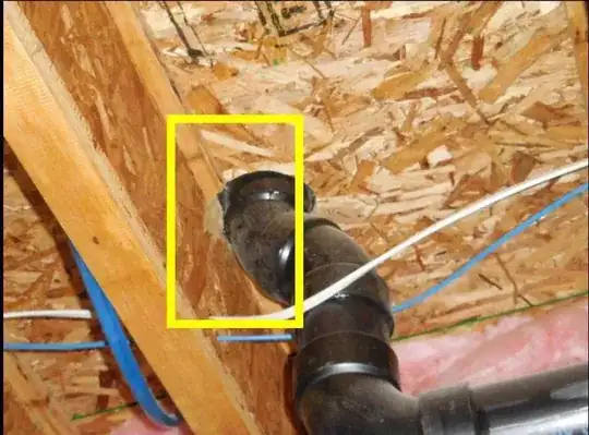

My home builder said that the following notch in a flange on an I-Joist was acceptable, but I've read that you're never supposed to do so. Is that true?

According to this document (PDF), accidental notches in the top flange may not need to be repaired if they meet specific criteria. To determine if a repair is required, we'd need a bit more information, including:
  • The distance from the center of the notch to the end of the beam.
  • The depth of the notch.
  • The specific beam used, including beam height.
If a repair is required, it may be as simple as gluing and nailing on a 2x4 and some backing material.
Diagram showing a repair option
This repair can be placed on either side of the beam, so in your case, it could be done on the side opposite the pipe.
Note that the building code specifically says "unless the effects of such penetrations are specifically considered in the design of the member". This means that the manufacturer of the beam is the one that determines what type and how much damage requires repair.
IRC R502.8.2 Engineered wood products.
Cuts, notches and holes bored in trusses, laminated veneer lumber, gluelaminated members or I-joists are not permitted unless the effects of such penetrations are specifically considered in the design of the member.
If you don't trust the advice of your builder, or simply want a second opinion, you could contact the local building department, and see if they'll come take a look. Contacting a structural engineer is another option, though I'm sure you'll have to pay them for their time.
While damage to these types of beams is concerning, it's better to seek professional assistance, rather than relying on the lunatic rantings of a bunch of dimwits on the internet. Now that you're done reading the lunatic rantings of this dimwit, seek the advice of somebody with a framed piece of paper on their wall.
    From the picture, I think the plumber exceeded the depth of notch indicated in the document you referenced. Even the TJI 210 has a notch depth limit of ¾". I would still opt for the single sided repair option that you indicated and not really worry too much about except for the back charging the plumber part. Lastly, I agree about the lunatic rantings though my OCD won't let me stop. – ArchonOSX Feb 24 '16 at 13:41

Point your home builder to page 9 of Weyerhauser's I-joist document. See the bottom right of the page where it says "DO NOT cut or notch flange". It is typical of all I-joist manufacturers' installation documents.
As Iggy pointed out, the I-Joist in question needs to be reinforced similar to a cantilever reinforcement.
To fix this, the electrical wires need to be moved to allow the joist to be sandwiched between pieces of OSB, if the pipe is moved, or at the very least have a piece of OSB attached to the backside of this spot. See the I-Joist installation document for how to reinforce for a cantilever.
Then, make sure to back charge the plumber for the repair.

The Is of I-joists are NEVER to be touched nor any holes within 3" of the top or bottom edges. "Responsible" plumbers & builders re-spec a toilet with a deeper stand-off or just pull it out enough to avoid any structural DAMAGE.
Either the entire OSB height (or okay down to the wires) needs to be sandwiched in plywood on both sides for at least 2' before & beyond the error (or as far as you can get to 2'). Or, a single 4' long 2x6 should be bolted to the OSB abutting the offending structural blemish.

    And to iterate on why you should never cut the flanges, it's because the flanges themselves bear nearly the entire load. – whatsisname Feb 24 '16 at 06:28
    Exactly! I-joists are great, but like everything else they have their limitations. The flanges are where the compression & extension forces are specifically focused. – Iggy Feb 24 '16 at 11:20
