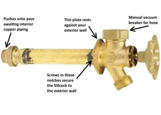

A common device used in the US (and required by some building codes) is a water outlet that is long so that turning off the water allows the portion exposed to the elements to dry out. These are called "Frost-free" or "freeze proof", etc.:
They come in different lengths, and the actual valve is all the way to the right of this picture where the copper meets the brass. This causes the entire valve to drain so no water is exposed to outside temperatures. The actual water pipes will be well inside the wall of the home and will generally not be exposed to freezing temperatures.

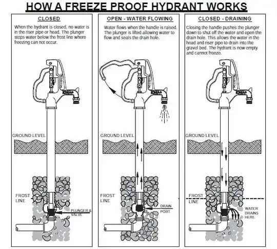

Here is another diagram to help explain from this answer:

  • thank you, just to clarify, I still need to make sure that there is no water pressure in the pipe, so I have to have another valve on the inside of the house, then just leave this valve open and let it dry out? If so, then there is no magic ;-), I wanted some solution I don't have to care about – AndyZ Feb 26 '16 at 13:56
    No, turning the knob on this valve closes the water off on the inside. It drains itself, and there is nothing else to do. One valve and done. – JPhi1618 Feb 26 '16 at 13:58
  • Oh..OOOOH....now I see, ok, that sounds a lot better :) Yes, thank you, I got it. – AndyZ Feb 26 '16 at 14:00
    **Disconnect the hose before winter comes!** I've had to replace my share of these and when I do, I add a valve anyway; these are not fool-prof. IME these sometimes only last a few years and if the vacuum breaker gets stuck, you'll be glad you put a valve in so you can shut it off and deal with it next summer. – Mazura Feb 27 '16 at 08:49
    You need to remove the hose so water can gravity-drain out of the pipe area (shown blue in the above diagram). If it stays in there, it will freeze and crack the sillcock. – Harper - Reinstate Monica Feb 27 '16 at 16:02

Fist gotcha is that nothing is actually freeze proof only freeze resistant (you were right to word your question that way) up to a certain point. Heating units are about as 'proof' as you can get, until of course they fail for whatever reason, and of course they have their own other drawbacks.

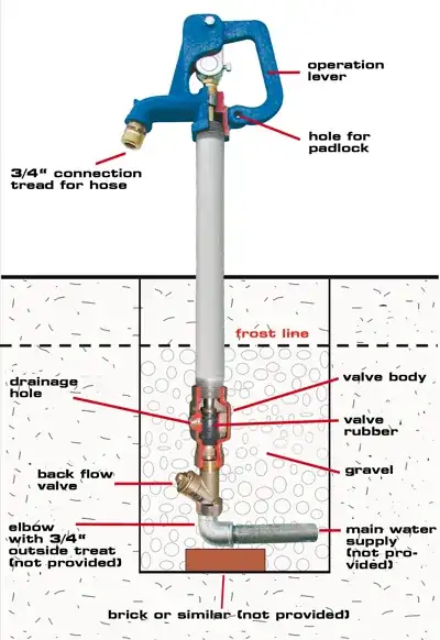

That said, assuming you want or need the bib to be located closer to the garden, what you may need is a Yard Hydrant. These will drain the water in the pipe down below the freezing line in the ground. You'll have to run a pipe to below the frost line, which varies on depth based on several factors such as temp and type of soil. Talk to local builders or city officials to find out what the frost line in your area is.
Yard Hydrant-1
Yard Hydrant-3
(The actual hydrants have much longer standpipes.)
These hydrants are great but they are expensive starting around $120 USD and up. Most installation instructions forget about telling you to put some kind of stone or block under the elbow fitting at the end of the pipe in order to support it better. You should also put some drain rock below and around it and I recommend some landscape fabric surrounding the drain rock.

The freeze proof bibs above work on the wall of a house. If you want the faucet further from the house this hydrant style works great. The supply line is buried below the freeze level and the base of the unit is bedded in rock when you turn it off the water drains into the rock. We have 3 of these for our horses and they have never frozen. I plan on replacing our other 3 standard bibs this summer as they always freeze and break the valve.
JPhi1618
  • 27,679
  • 52
  • Thank you, no, I was thinking about a solution on the wall of the house. But this hydrant seems to be made of gold, at least the price suggests that ;-) – AndyZ Feb 26 '16 at 14:03
