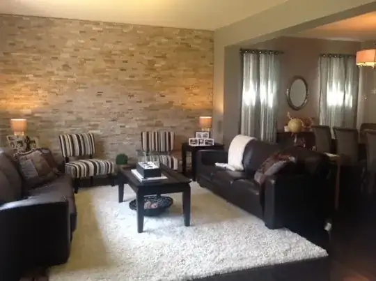

Here's the project that we completed last month. thanks to Iggy and D moore

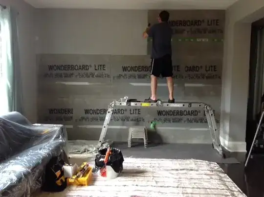

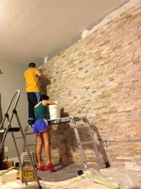

  • thank you iggy an dmoore. finished it last month used 2.25 inch screws and used cement board as well to reinfoce . very strong thinset used for the mortar. thanks for the input. – DIY fanatic Jun 16 '16 at 19:33
  • Fabulous & so much better, great job!!! Personally, if you're thinking of caulking or mortaring the top & sides, don't...I prefer the black shadow line look & future painting is much easier & cleaner. – Iggy Jun 16 '16 at 23:51
  • Looks great. Glad you went with the lite board vs durarock. This will put less stress on the drywall. Either way I don't think it is a big deal since the stones don't weight that much but I like to give the best answer - your solution will be fine. – DMoore Jun 17 '16 at 04:54
