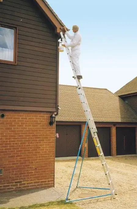

I used eye-bolts to anchor my ladder to my wall.
random intertube photo - I just used rope and carabiners etc
If I needed more security I would probably buy ladder-stabilisers or lash a plank to the bottom (less likely for ladder to rotate) and maybe buy a harness to clip myself to the ladder.
For soft or uneven ground I once made a ladder-shoe from wood and hammered stakes (tent pegs) through it to stop it sliding.

    What is the top of that ladder supported with, because that picture is freaking me out. I'd have to see that in person because it looks _very_ wobbly to me. – JPhi1618 Mar 01 '16 at 18:36
    Also, that ladder is about 20 feet high. Imagine a ladder stretching another 10 feet up so it reaches the peak of the house, that is how high I need to go. – Tyler Durden Jun 30 '18 at 11:19
