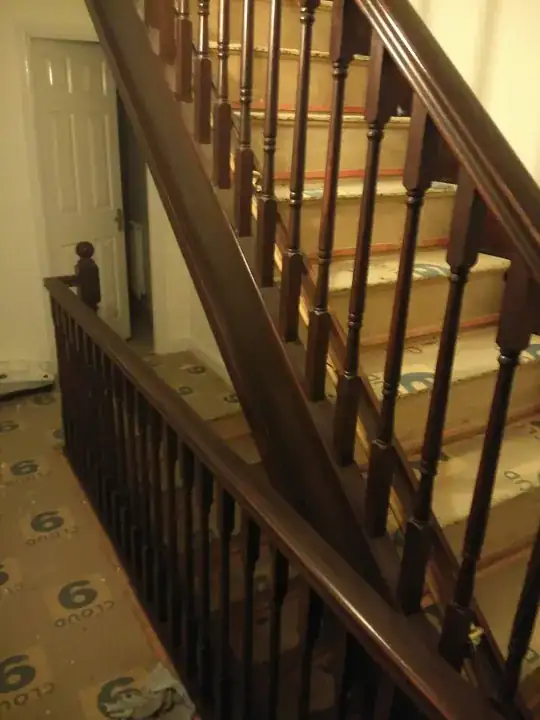

My house has 3 stories, and from the first floor to the second it has spindles.
My issue with them is that they seem very rickety, and don't support any weight what so ever.
Is it possible to secure them?
enter image description here The top set seem to be much worse than the bottom.

  • The hand rail feels rickety, or the spindles can move around? – Tester101 Mar 02 '16 at 23:42
  • The entire thing shakes with little to no effort. – Terry Mar 02 '16 at 23:43
  • Are the newel posts wobbly, or does it feel like the handrail is not connected well to the newel posts? – Tester101 Mar 02 '16 at 23:50
  • The entire thing feels quite loose. How do I identify the newel? – Terry Mar 02 '16 at 23:51
  • The newel post, is the vertical post that the handrail attaches to. In your photo, it's the vertical (4×4) post in the left-center of the photo. The one with the large knob on top. – Tester101 Mar 02 '16 at 23:55
  • Thanks for the explanation. I'm not at the house anymore but I'll see if that one is loose too. – Terry Mar 02 '16 at 23:57
  • The balusters (spindles) don't do much to add structure to the railing, other than keeping the handrail a fixed distance from the bottom rail. In fact, they typically sit in the plow of the handrail and bottom rail, and are only held in place by pieces of fillet. They offer little to no lateral support. – Tester101 Mar 03 '16 at 00:04
  • So the spindles between the newels are mostly for show? – Terry Mar 03 '16 at 00:07
  • If the railing is wobbling, it's not likely a problem with the balusters. Either the newel is damaged or loose, or the handrail is not firmly attached to the newel. – Tester101 Mar 03 '16 at 00:08
    The balusters hinder you from slipping under the handrail. – Tester101 Mar 03 '16 at 00:12
  • Have you made any progress determining what's loose? – Tester101 Mar 04 '16 at 14:08
Stair hand rails are primarily supported at the top and bottom by the newel posts. While some additional support is needed in a span over 5 or 6 feet, the handrail does not need dozens of braces. You will often see an inside wall handrail with attachments that are several feet apart. The spindles are primarily intended for safety, to prevent someone from slipping under the handrail on an open staircase.
No spindles on a full handrail run would allow the rail to flex too much, so they are necessary. But if a number of them are loose, there is little likelihood of risk unless the attachment at the newels is also compromised.
Having said that, it makes sense to firm up the spindles. Driving 1 1/2 or 2" finish nails on an angle, pinning the tops and bottoms of the spindles to the handrail and the base should probably do it (much easier with a nailgun).
