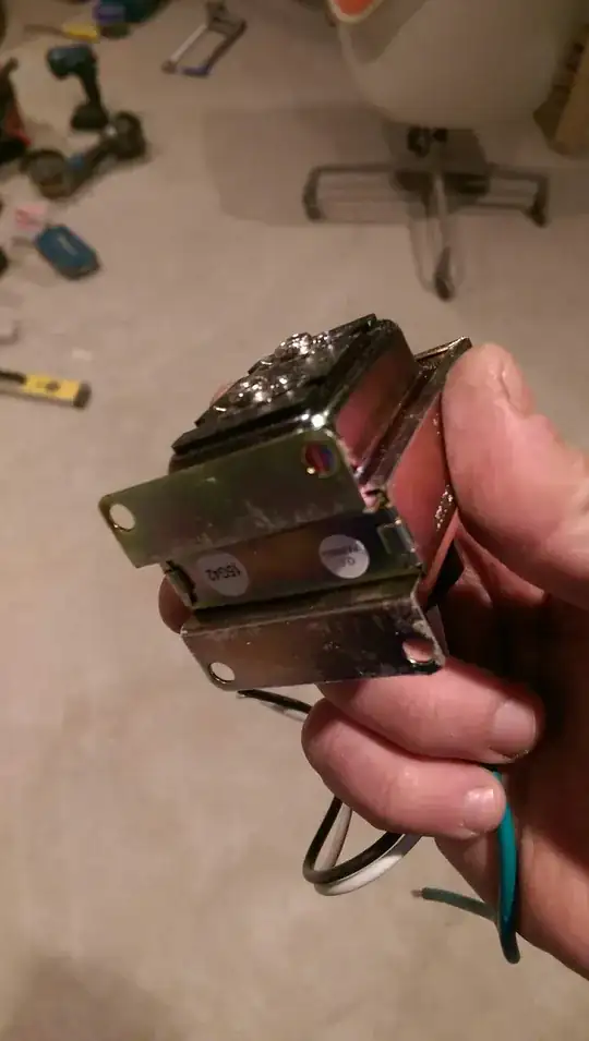

Can a low voltage transformer for a doorbell sit loose (not screwed to anything) inside the main panel or does it have to be affixed somehow? It came with holes but I'd need to drill holes in the panel to attach it, unless I can just wire it and sit it on the bottom of the panel.

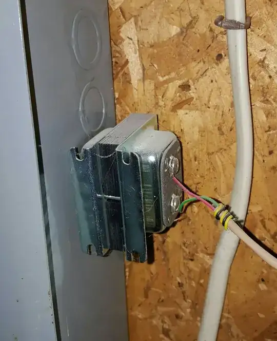

You won't want to install the transformer inside the panel. Instead you'll install it on the panel.
  1. Remove the retaining nut from the threaded fitting on the other side of the transformer (the bit in your hand).
  2. Feed the wires and threaded fitting through an appropriately sized knockout in the panel.
  3. Thread the wires through the retaining nut, and tighten the nut down on the threaded fitting.
  4. Connect the primary wires from the transformer to the proper terminals in the panel.
  5. Connect the low voltage wires to the terminals on the secondary side of the transformer.
  • That transformer looks to be installed upside down. The bracket should be facing the wall and screwed in place I think. – ratchet freak Mar 07 '16 at 10:23
  • Also wouldn't a fuse be advisable for the low voltage side? If the red and green short then there is a very high amperage required before the breaker on the high side will trip (5 times as much assuming it's a 120v to 24V transformer) – ratchet freak Mar 07 '16 at 11:42
  • @ratchetfreak Modern doorbell transformers have a self-resetting thermal switch internally - if the transformer starts heating up, then it disconnects the primary. Decades ago they had small fuses on both legs of the primary, but thermal detection performs the same overcurrent protection as well as thermal protection. – Adam Davis Mar 07 '16 at 12:25
    @ratchetfreak, no, the finger nut on the inside provides the support. the screw tabs are only used if you don't use the finger nut. – longneck Mar 07 '16 at 21:25
