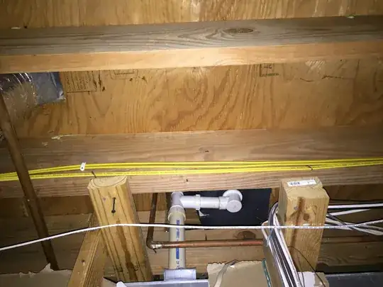

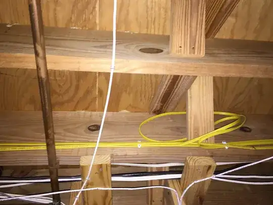

Photos from the basement where plywood and joists are. Photo 1, you can see the tub drain and joists where the tub would end and the dip occurs. Photo 2 is just to the right showing the same joists further over. It looks like the tub is sitting on top of the plywood, which is 23/32 according to the label underneath. I wonder if the weight along with a crowning joise is the issue.

  • Great pics, thanks! However, I don't see anything out of the ordinary nor of any concern whatsoever...outside of an un-driven screw & 3 illegal white wires that should've been drilled into the joists. But yeah, I'd have to side on a crown-down joist sag. If you have a level or some other actually straight stick or pole to lay over 2 neighboring joists. See if the stick or pole hits that tub edge joist or the one outside of it to indicate a sag. Or, tape measure to the floor for any differences. – Iggy Mar 16 '16 at 13:17
  • From underneath, they are all flush. @ 12" OC with the cross bracing it's tough to see if there is any flex or dip on the underside of the plywood where it meets the joists. The white wires are speaker wire, not romex. – Chris Rasco Mar 16 '16 at 13:50
  • Also, the floor doesn't flex at all, but for a frame of reference, they did a dry pack mortar bed on top of this originally. See my other question: http://diy.stackexchange.com/questions/84234/what-is-the-2-inch-layer-of-masonry-under-my-bathroom-tile – Chris Rasco Mar 16 '16 at 13:51
    Don't worry about the wires, I figured they were TV coaxial or speaker or low-voltage lighting, just don't carry any shovels around with the blade up. Otherwise & thankfully, everything checks out & it should be nothing but a warp from the old mortar bed's moisture. Thanks for checking everything out & working with me, I'm real glad that nothing structural needs to be done. I'd say you're good to go with the filling & leveling. You new floor should be fabulous for decades. – Iggy Mar 16 '16 at 14:12
