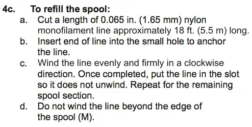

As soon as I start running my Kobalt KST 120X-06 weed eater the line immediately unspools very quickly (like 5 inches a second). It is like the autofeed is always on. I have made sure I am spooling correctly:
http://pdf.lowes.com/operatingguides/841821017460_oper.pdf enter image description here
I have also tried spooling it the opposite directly in case I am somehow confusing what clockwise means in this case.
What might be going on here?

I just figured out the answer to the problem. I had this exact same problem and just fixed it. The problem is the winding of the cutting filament. As long as all the mechanics look correct and working make sure the filament is wrapped around the spool in a clockwise direction (when looking at the spool). I tried that and it fixed the problem and I just weedeated my back yard.
