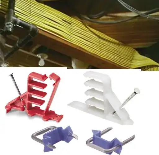

Avoid hanging wires from or attaching to gas lines, plumbing lines & ductwork. Running over or next to them is fine & normal. Avoid the top picture below as this can splinter dimensional or standard building framing. Instead install furring strips to staple into. Keep all wires at least 1-1/2" away from framing edges. You may find the below stackers easier to use than a whole lot of staples.
wire securing

  • Iggy, you have provided listed means for more than 1 wire+ – Ed Beal Mar 26 '16 at 23:02
