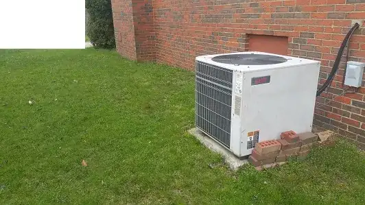

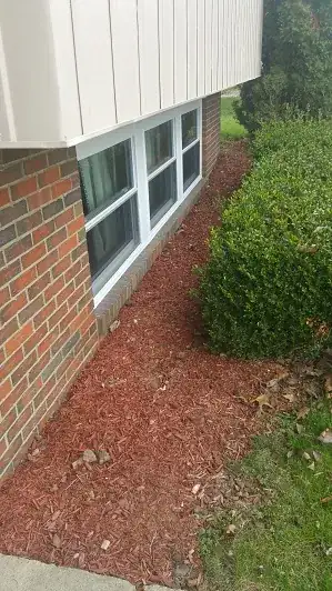

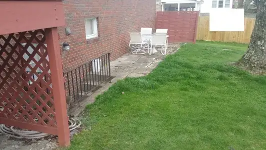

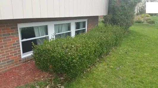

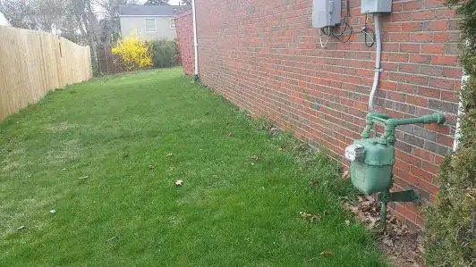

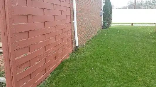

EDIT: here are some requested pictures.
Front Right Front Right Right Side From Front Right Side From Back Back Side Left Side From Back Left Side From Front Front Side from Left

  • What is at the bottom of those downspouts? Is that a pipe into the ground, or does it just drain onto the top of the ground? – wallyk Mar 31 '16 at 05:35
  • It's a pipe into the ground, but I'm not sure where it goes. – Frank Bryce Mar 31 '16 at 23:47

Only re-grade if you're getting water intrusion or even a damp musty basement condition. If neither of those yet, then don't do anything. Otherwise, re-grading is a good deal of work, but quite simple in procedure with just a shovel.
Dig a shovel depth trench at least 6-feet away from the house that pitches down toward the street or into the back yard. What comes out of the trench goes against the house & then you widen the trench toward the house while digging more & more shallow to achieve pitching away from the house.
The Gas Meter (may be the picture angle), Front & Driveway sides all look good. The patio should be ripped out & redone with a properly pitched concrete slab, re-grading would be part of that job by default. But really, only the AC's side would need to be re-graded at any point or in your lifetime. But, put elbows on your gutter downspouts, they aren't helping matters at all.

Hmm, judging by the pictures you posted, it doesn't actually look like you need to do a lot of regrading. The only place it appears the lawn slopes towards you house is along the side with the AC unit. Especially if you're near the top of the hill, you aren't getting a lot of runoff.
In terms of grading it yourself, it's completely doable, but it's going to be a few weekends of shovel-work, plus re-seeding the lawn.
From my experience (working for a landscape contractor a few years, and ownership of one house in the pacific northwest) you'd be better off installing a french/curtain drain along the one side that slopes towards your house, and keeping an eye on any standing water during the rainy season.
