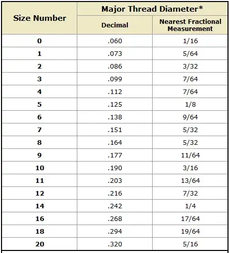

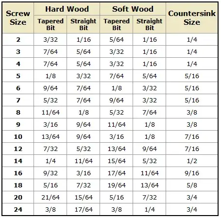

Here are some charts from Bolt Depot. Bolt Depot is a handy resource, and has lots of information about all different types of fasteners.
Pilot hole size:
Pilot hole chart
Wood Screw Diameter:
****Major thread diameter** is measured on the outside of the threads.*

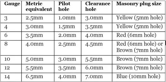

Here is my chart drawn up from over 30yrs onsite experience... (sorry its in millimetres for those stateside!)
Screws explained...
More detail here screws explained chart. (NB based on UK/EU experience)

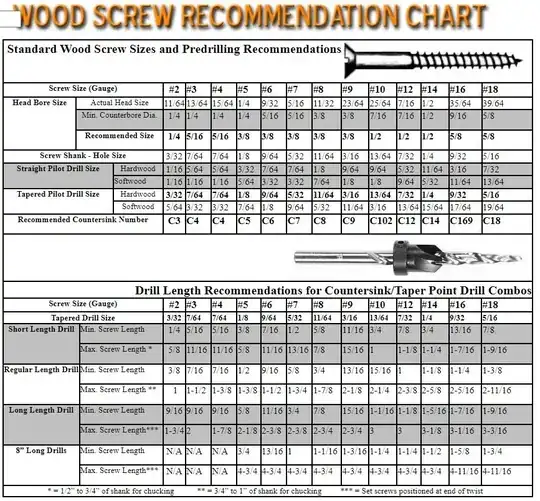

The best charts I have found for both tapered and straight wood screws is at http://www.wlfuller.com/html/wood_screw_chart.html - the fuller company has been around forever and it shows with the customer service and the accuracy of the advice. Wood screw chart from wlfuller
