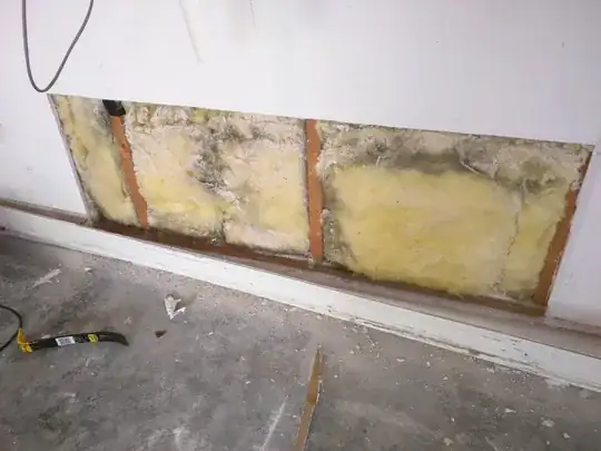

Let's say I have a hole like this (not my actual hole just one that I found for my situation)
As you can see the existing drywall is flush with the 2x4. What I want to do is cleanly cut away enough of the existing drywall (about an inch) on both sides so I can put in a new piece to fill the hole and screw to the existing 2x4s. This seems like a better approach than screwing pieces of wood to the top and bottom and mounting the repair to the existing drywall. The problem is that the only way I can think to get that inch is to kind of stab at the drywall and pick away little bits at a time.
Edit
Due to all the interest, here's my actual wall/hole. On the left I ended up cutting it past the stud because there was another dent in the wall. The story is that the previous owners, in their 80s, hit the wall leaving big caved in portions of the drywall.
[Real situation

You want to add backing to the inside sides of the existing studs as well as to the centre of the span. The simplest way to do this is to cut the new backing (preferably 2x4, or whatever the existing stud dimensions are) about 4" longer than the height of the opening and screw them to the existing studs. The cut one more piece of backing to the same length as the other two, but this time place it in the centre of the opening and screw through the top and bottom of the existing drywall to attach it. See the picture below for reference.
This method will be much easier than trying to score the existing drywall back on the existing studs and will provide a solid patch.

    What's the purpose of the strip in the middle of the hole? – Tester101 Apr 14 '16 at 12:34
    @Tester101 Depending on the size of the hole, you could get flexing in the drywall if you did not add the center support. – beattyac Apr 14 '16 at 13:53
    Why have that center vertical strip instead of horizontal strips to support the other seams? –  Apr 14 '16 at 14:11
    The thought is that if you used horizontal strips on the top and bottom, they can twist or rock when you apply force to the edge of the patched piece, resulting potential cracking. Using a long vertical piece should help prevent this as it is distributed over a longer distance perpendicular to the seam. For the best result, extend well past the hole allowing for multiple screws into the existing drywall at the top and bottom. – pdd Apr 14 '16 at 16:56
    The building trades term for adding a framing member (stud/joist) next to another is "sistering." Sistering studs or joists is used when the existing framing member is not strong enough or in this case, wide enough. As other commenters point out, having 3/4" (half a stud) isn't a sufficient nailing surface for the new drywall patch. Screws placed within 1" of the edge have a habit of cracking the drywall. Experience has instructed me to keep fasteners at least 2" away from unfinished (cut) edges. For that middle nailing strip, I find small pieces of scrap plywood work great. – Matt Simerson Apr 14 '16 at 17:10
I'm a Drywaller of 25 years, the saw blade suggestions are DANGEROUS there are possible screws going up the center of that stud ... do not use a saw blade, the guy who suggested the utility knife had it right, make sure you have a screw gun handy incase you come across a screw.
Use a utility knife to score through the drywall. It will take several passes to get all the way through. Go slow, be careful, and don't over cut at the ends. Only go 3/4" onto the stud, going an inch or more could cause you to expose the whole stud and weaken the drywall on the opposite side.
I do agree that doing this is not enough for that wide of a span. You really do need to screw some wood (furring strip 1x2, or bigger) to the top and bottom of the hole to support the seams.

Assuming the hole is the width of a typical stud bay, just attaching the patch on the edges is not a sufficiently strong solution. Screws (or nails) near edges weaken the structural integrity of drywall and the patch is likely to shift and crack eventually.
I would attach short pieces to each stud for mounting the sides and 1x3s top and bottom to span the gap.
While you could carve a strip from the drywall with a utility knife to expose the studs, I would urge against it.
