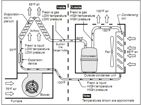

Basically if the system cannot exchange the heat/cold, it will not function properly and could lead to over heating/cooling.
Frozen lines could also be caused by high or low levels of refrigerant, so you'll want to get a service person out to check the refrigerant levels.
Here is a really good image to visualize how it works.
