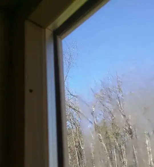

  • I've added a picture. Would you consider breaking a pane and just pulling out all the shards with pliers? – Stephen Ostermiller Apr 20 '16 at 15:54
  • Still think smashing is a poor choice -- especially if they're tempered (as was hinted in your other question). Try pulling away some of the trim around the sealed unit to see how it's held in place. As others have noted, sealed units can be made to exact size specs at reasonable prices. – Aloysius Defenestrate Apr 21 '16 at 00:52
