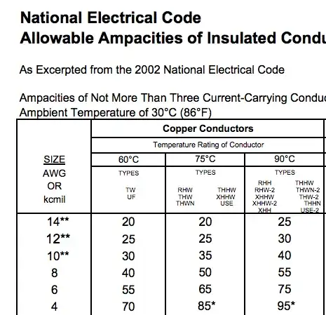

According to the National Electrical Code, you need to use 10 AWG or better to carry 30 A safely::
