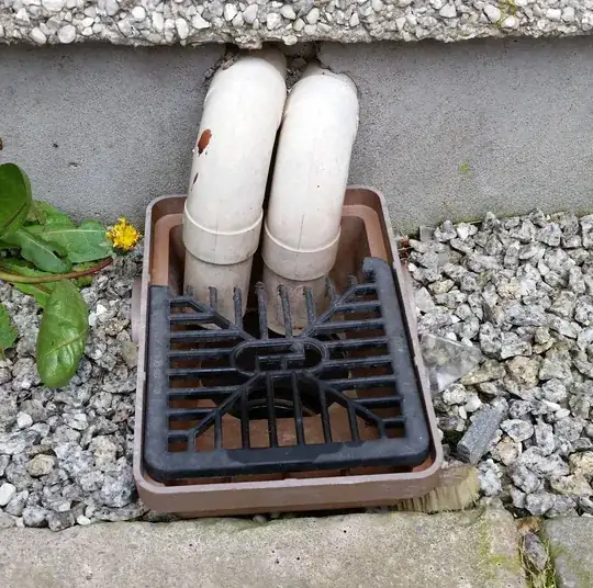

We live on a windy coast of North Sea. High wind is a norm here. One of the problems I face with the wind: it comes out from kitchen sink drainage pipe. If it is blowy outside, you can feel a draft coming from the drainage pipe.
I think the problem is because the drainage pipe finishes outside and does not make a sealed connection: Drainage pipe is not sealed
Because the drainage pipe is not sealed, the wind blows up the pipes and comes out from my sink drain. Making the kitchen colder (we have enough vents there already!)
Is there anything can be done to prevent this draft?
I'm thinking cover the drain hole (the one on the picture) with something, but could it not cause more problems?

You don't have a trap seal, to prevent air from moving through the drain.
Only the dishwasher is draining through the trap, so there's no trap to prevent air from coming up the drain. you'll have to fix the plumbing, so that both the sink and dishwasher use the trap.

    A vent is **not** needed, as the pipe exits into a outside drain with a air gap. Even if the pipe was sealed into the underground pipes, a vent is often not needed provided the underground pipes are vented correct by he soil stack. (lots of examples in the UK building regs). – Walker May 03 '16 at 10:35
    Thanks @Walker. I'm not familiar with UK plumbing, so it's good to know that the vent is not needed in this situation. The OP should just be able to swap the connections, and be all set then. – Tester101 May 03 '16 at 11:36
  • @trailmax Walker says you don't need a vent, so just swap the connections and enjoy. – Tester101 May 03 '16 at 11:38
  • @Walker thanks for confirming this. B&Q staff yesterday were puzzled when I asked about AAV. And there is no space for a proper vent anyway. – trailmax May 03 '16 at 12:11

You could put a cover over the drain box but when you do so it has to allow for free air flow so the isolation afforded by that air gap drain box still functions properly. If I was making the cover it would have a baffle design with a double wall construction. See figure below:
The inner wall of the baffle cover would sit on the ground or maybe even set below grade. The outer shell would not come all the way down. The picture is somewhat conceptual and does not attempt to show how the two parts of the cover fasten together.
Before committing to an elaborate construction project you could prototype the design to determine how effective the concept is. This could be done using heavy corrugated cardboard carton material. You easily cut the cardboard with a sharp utility knife and a straight edge. The pieces can then be joined together with hot melt glue. (Hot melt glue sticks to the brown corrugated cardboard amazingly well). Hold your prototype in place using some bricks to keep the howling wind from blowing it away.

While I agree that this was assembled backwards I think the apparent lack of a vent is acceptable here. It looks like it basically goes through the wall and then into that box outside--so long as it's close enough to the sink that would suffice for venting.

An easy test would be to cut a panel out of some junk styrofoam, that would go under the black grate, and block up but not tightly seal, the tub that the white pipes drop into. It's free and easy to work with, and if such a block cuts down on the wind problem, you can then make something more permanent and better looking.
  • Sounds like this is the sink drain, so it's actively used. – Daniel Griscom May 02 '16 at 14:00
  • I mean around the pipes, not underneath (and thereby blocking the outflow). – Pete Danes May 02 '16 at 14:02
  • Ah. You might also consider wind blowing up the external drain pipe; there's no info on where it actually goes. – Daniel Griscom May 02 '16 at 14:04
  • Cutting a flat panel out of junk styrofoam that would sit where the black grate sits now, roughly around the pipes, but not tightly enough to seal would block wind from the entire system. Put a rock on it to keep wind from flipping it out, and see what effect it has. – Pete Danes May 02 '16 at 14:12
  • It's unlikely, but I was wondering if wind could come up the lower drain pipe itself (e.g. if it ends pouring off some cliff somewhere). Absent that, good idea, although you might want to make the answer clearer on exactly what you're blocking. – Daniel Griscom May 02 '16 at 15:13
