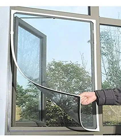

A screen mesh curtain is what my mother-in-law uses on her windows. It is fairly inexpensive and very easy to remove for cleaning.
It can be found on Amazon for $10 per 2 pack.
