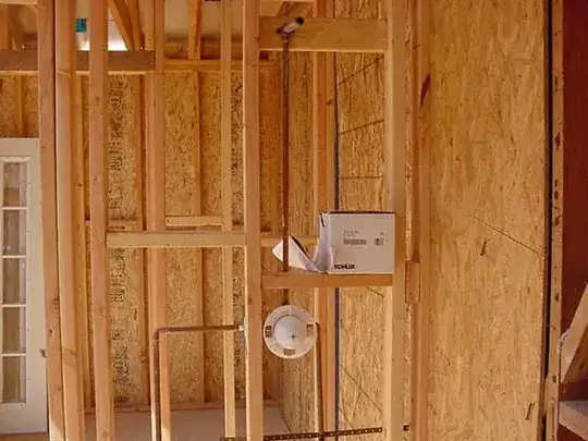

This is a picture of one example of a rough shower plumbing install:
As you can see, at the top there is a cross brace, and there is a 90 degree angle that's been mounted into that brace secured, preferably with screws but possibly with nails.
My guess? Your shower head was braced with nails, some idiot hit your shower head pipe pretty hard and pulled the nails loose, and the sound you heard was one of the nails falling out.
It's not serious - as long as you don't put any weight on the shower head - and the fix will involve opening up the walls. Technically you can fix it from behind, so you won't have to destroy tile in the process, but that's a harder way to do it. Basically you have to pull the wall behind the shower, cut the pipe to the shower head, pull the brace, re-secure the shower head, replace the brace, and then fix the feed to the shower head w/ a connector.

  • Thanks for the info. Due to the way it moves left and right, it seems as though it's not secured to whatever it was secured to before. I just talked to the guy again and he's going to come out and shoot foam into the opening so that he doesn't have to open the wall (it's just drywall). Does that sound like a professional fix or just a hack to get in and out as quickly as possible? – oscilatingcretin Sep 22 '11 at 17:13
  • It's a hack. However, as long as he doesn't overfill the void (and thus blow out the drywall), it could work. – The Evil Greebo Sep 22 '11 at 17:17
    The foam is a complete hack, it will eventually become lose again, and by that time, the contractor will be long gone. – BMitch Sep 22 '11 at 17:41
  • BMitch is right - I wasn't thinking about how pressure on the foam will cause it to collapse over time. That mounting angle really should be screwed into the brace to fix this properly. – The Evil Greebo Sep 22 '11 at 17:45
  • Good call, Greebo. His son came out today and suspected that he had indeed knocked a nail loose, but not out. He enlarged the hole in the drywall, put a screwdriver through against the head of the nail, and pounded it in. It's in super sturdy now. You were spot on! – oscilatingcretin Sep 22 '11 at 18:34
