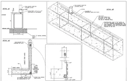

Perhaps foolishly (no one we've spoken to in the area has tried to permit a greenhouse), we took the plans to our local permitting office. The only particularly difficult part we've run into is the foundation. As purchased, the plans were for a standard installation with a more house-style foundation. We were presuming that it would be extremely easy to do a foundation as frost heaving and bearing weight aren't a concern. The only engineered diagram we've gotten past the permitting office is a 24" tall x 14" wide concrete beam poured directly on the bedrock.
Engineered drawing
Our issue is that this seems to avoid all the benefits that exist with the exposed bedrock, makes it virtually impossible to do ourselves just due to the volume and the associated risk of mistakes, and is crazy expensive without much perceived value.

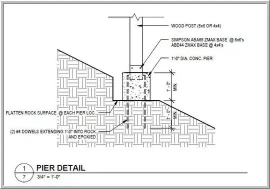

I've seen this related question, which basically ends up with something like this: Pier on bedrock
Are we missing why this same principle cannot be applied with just enough concrete to level out the area and provide a consistent and level wall to form the perimeter of the structure? Is 2' high really required, or is this a case of the engineer getting fed up with the back-and-forth with the permitting office and over-engineering it?

Late Update: After building a few small outbuildings, we were misunderstanding the concerns addressed in the design. The massive foundation is essentially a humongous anchor. If hurricane force winds come through (and in this imaginary scenario I guess the plastic holds to the frame better than the frame to the ground anchors) the foundation is spec'd so the whole building doesn't lift up and blow away. All that to say the bearing weight and heaving are not large concerns as we were thinking they are.
To summarize, it is almost exclusively uplift which is being addressed by the massive amount of concrete. No engineers are willing to say the bedrock is really bedrock without a (hugely expensive) core sample (I guess the system works?), so the building has to be designed to not fly away with no consideration of the uplift resisting ability of the ground underneath, or fastening systems attaching to the ground.

  • Maybe I'm not understanding, but it looks like the engineering drawings have 1/2" x 5-1/2" expansion bolts in the concrete. Could you get the engineering team to (1) specify the expected holding power of the bolts, and then (2) cross reference against holding power of similar bolts in Shield? – Aloysius Defenestrate Jul 19 '16 at 04:19
  • @AloysiusDefenestrate we've just recently discovered that our concerns are a giant red herring. The concrete as designed is an anchor more than a foundation. So yes, I believe you're on the right track, we'll have to find someone who can sign off on the... uplift resistance (?) of the ground. – user2152081 Jul 20 '16 at 16:04
