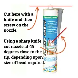

For UK users there is no separate seal as such, it's part of the tube itself. The top of the threaded part that goes into the nozzle is cut off using a craft knife.
UK type caulk tubes

    Or apparently for other european countries! Thank you very much, I was only finding the other type of nozzle and I was very confused how to open mine – Mel Nov 05 '22 at 10:10
