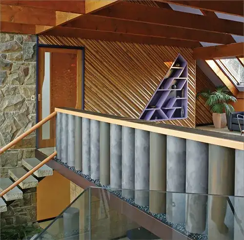

PCMs or water filled containers have much greater thermal storage capacity than masonry and can be used as a mass substitute. PCMs are much lighter than masonry. Water has double the storage capacity of concrete and because of convection within the container, penetration rates are substantially higher. Thus water can supply similar storage capacity to masonry with significantly less mass and bulk. Accordingly, both can be cost effective mass options for upper storeys because they require no (or less) additional structural support.
Water filled balustrades provide abundant thermal mass as part of this mezzanine balcony.
Photo: Mike Cleaver, Clever Design
