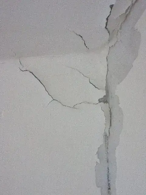

Update: Here are some photos of the areas. You can see in the first two the gray, smooth, stony surface behind, and the brown paper. The seam visible in the 2nd photo makes me wonder if this is paint over wallpaper? In photos 3-5 you can see what looks like evidence of drywall, or at least a past patch job with tape and mud.

1) sample crack
damaged plaster
2) Wall crack not through gray surface, but showing seam / brown paper on the top layer
damaged plaster

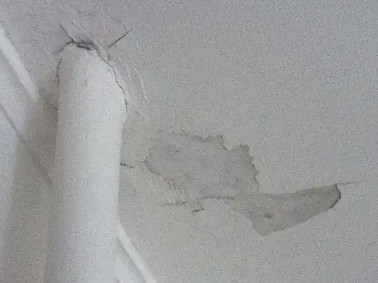

6) Vent pipe for septic system, with chipping/peeling/flaking top surface. There are no long cracks present in this area, just what's visible here around the pipe aperture.
damaged plaster
7) Dormer leading up to the attic. Here you can see (faintly, sorry) the long horizontal crack, which then forms a Y and cuts at a diagonal down and to the right, while continuing horizontally as well. There are several places where cracks like these appear, spaced about 2-3 feet apart, which is what made me suspect rock lath plaster in the first place.

If wallpaper was painted over you could tell pretty easily by pulling on some of the peeling paint and breaking the paint chips. Wear a respirator mask while doing this, however, as often times flaking paint is a potential indicator of lead based paint. If the chips contain paper, then you're right, it's wallpaper with paint over it. If it's just paint, then be more careful - get the chips tested for lead.
Given the wide spread flaking, it is likely that the wall simply wasn't properly primed. An improperly treated wall when painted over will eventually lose adhesion with the paint and it'll flake away like you're seeing. If they applied paint directly to wall paper w/o priming, I think the same is true.
That 2nd picture DOES remind me of wallpaper... I've scrubbed far too much backing off the walls and that looks similar.

Now around the vent pipe, that looks like moisture damage. The bubbling around the pipe suggest water leakage. Is that a "finished" ceiling - ie - thats the roof on the other side of that wall w/ the pipe? If so, make sure it's properly sealed and replace at least that area of ceiling. Picture #5 seems to confirm this - someone touched it, and patched it badly.

  • So if I follow you, you think the gray surface is something applied on top of existing plaster lath? The age of the house, I should mention, is 1925, and the literature I've found seems to suggest rock lath plaster was not widely being used back then. But then, this is the attic, which most likely wasn't finished until later. I was wondering if the pipe area was water damage - yes it's the roof on the other side. – mcw Oct 03 '11 at 16:16

  • I see. We're still in the stage of "oh no do we really need to gut this or not?" planning :) I like the cross-section idea. I'm trying to get a sense of how viable the stucco subsurface will be if we did want to try to strip/scrape and repaint. My big worry is if the cracks go through that stuff or not - they don't seem to in _most_ places, but then there's photo #1. – mcw Oct 03 '11 at 18:45
