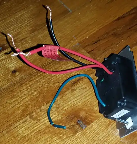

enter image description hereenter image description hereenter image description hereI am trying to figure out how to install a 3-way switch. Unfortunately, I did not took any pictures of the previous 3-way switch installment, I thought this would be easy but after I bought the new switch, I saw it has different color wires and now I have no idea how to make this work. I have took picture of the exposing wires, as you can see, 2 blue and 1 orange. The new switch has 2 red, i black and 1 green. How should I connect this? Any advice? I also took a picture of the other ends switch. Not sure if this will help. Can anyone advise please?

This looks like a 3-way slide dimmer.
In the first picture it looks like there are five wires. Two black, two blue and one white(?). Is that correct? Can't tell what the white(s) is(are) connected to, if at all.
Just looking at the pictures(which are leaving out some needed information) and seeing that these are 4-square boxes, the box in the second picture has the travelers and switch-leg for whatever light is being controlled. Then the box in the first picture is most probably a feed in from the light box(common in older houses), a feed out to the nearest receptacle and the travelers going to the second box. Both boxes are probably junctioned somewhere, maybe in the attic or the light box itself.
Here's my take: if it is a feed in/feed out then there should be two white wires tied together in the first box. Black on the switch is the common, so it should be tied to either the paired blacks in the first box or the orange wire in the second. The red leads on the switch should be paired to blue wires in whichever box you're installing the switch(one red to one blue).

Interesting colors... without a multimeter (I assume that's the case), the best answer is to use the light to test the connections. When wired correctly, the light should turn on and off at each switch (a switch should not need to be in one position for the other switch to work). The green wire should be the ground and it should be attached to the outlet box with a grounding screw.
Use a piece of tape and mark the wires (Red1, R2, Blue1, B2). Use the following possibilities (there are only 6 possibilities; check them off until you get the right order):
  1. Red1-Blue1, R2-B2, Blk-Org* chances are, it's this one
  2. Red1-Blue1, R2-Org, Blk-B2
  3. Red1-B2, R2-Blue1, Blk-Org
  4. Red1-B2, R2-Org, Blk-Blue1
  5. Red1-Org, R2-B2, Blk-Blue1
  6. Red1-Org, R2-Blue1, Blk-B2
Caution: You will need to turn off the breaker every time after checking- before wiring and rewiring.
Edit 1- Regarding a three way switch it is common to make the "common" screw or wire a different color than the other two traveler screws or wires. A green wire is almost always the ground. So I believe that the two red wires on the switch attach to the two blue wires in the box, and the black wire should attach to the orange wire in the box.
To gather a little more information, you could take the lamp out of the ceiling and see what color wire(s) are connected to the lamp. Again, my bet is that the wire connected to the lamp is orange. There will also be a neutral wire connected to the lamp.

Edit 2- Regarding the new picture that you added, it looks very much like the black wires in the wall (switch 1) are hot and the blue wires are travellers.
The switches being used are kind of unusual. I also see now (with the new picture) that one of the red wires is probably the "common" terminal, and the other red and black wire are the leads. If switch 1 is wired correctly, then (on switch 2) the red wire with a tag and the black wire are the travellers, which each attach to one of the blue wires, and the orange wire is the switch leg which attaches to the red wire (switch 2) without the tag.
