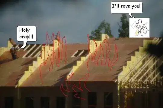

While watching the builders next door do their thing, I became curious with their technique to install plywood on edges neighboring the next townhouse, and OSB for the rest (which for these narrow interior units is a single panel in the middle, but they use OSB all the way to the non-attached side on the end units). What's the reason to pick one over another?
photo of the roof
Follow up: I'm guessing this is related to OSB's tendency to expand on the edges when wet, possibly for the flashing and the plywood side of the firewall that would rest on top of this edge of the roof. Here are some links that I came across when doing a bit of research:

It could be that they are trying to slow down a fire from spreading. The material at the edges might be more fire resistant, so the fire will spread to adjacent buildings more slowly, allowing the occupants more time to escape. You might be able to verify this by checking the local fire codes for conjoined (not sure this is the right term) buildings.
See how if there was an MS Paint fire, the flames would stay away from the next building (assuming the material in the middle burns faster). enter image description here
The man would then have more time to get to safety, or be saved by Captain Construction.
