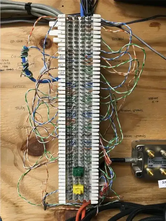

I have a Cat 5 ethernet cable that runs from a stereo cabinet to an equipment closet. A couple dozen other identical cables run from other parts of the house to the same hole in my drywall in this closet. They’re not all well labeled. Originally, the cable in the stereo cabinet served as a telephone connection, with a 4P4C jack in the cabinet and the other end punched down into a 66 Block in the closet (question edited to show 66 Block photo).
Now, I want to re-purpose that Cat 5 cable to serve as an Internet connection to the cabinet. I have already re-terminated the cabinet end with an 8P8C Ethernet jack, and I want to find the other end of this cable in the closet so I can connect it to our data network.
If the cable from the stereo cabinet weren’t punched into the 66 Block, I think it would be easy enough to find it, using an answer like “How can I find out which ethernet cable goes where?”. But if I were to use a Tone Generator and Probe, then I would expect for every cable in the house that serves our phone system (all of which are the same gray Cat 5, and all of which are tied together in that 66 Block) to probe positive exactly like the one cable I’m trying to find. Right?
Because of this, the only way I can think of to find this cable is to start pulling wire off my 66 Block. However, I don’t want to do this unless it really is necessary, because I’m fearful that I’ll mess up our home phone system in a way I won’t be able to repair. (One problem I foresee is that I don’t have a lot of extra cable length to work with for punching wires back down.)
How can I figure out which of the many Cat 5 cables that are punched down into the 66 Block in my closet is the one coming from my stereo cabinet?

Is your 66 block configured with bridge clips? If so, just remove the bridge clips and your many CAT5 cables will be isolated from each other, you can individually probe them to find the one you want, then reinstall the bridge clips.
I'm assuming your 66 block is not configured like that? How is it configured? Can you include a picture?

I zoomed into to the picture and I see writing on the plywood on either side of the punch down block. Many labels such as "master bedroom", "xxxx bedroom", "office", "study", and "kitchen" should surely help to distinguish where most of the cables are routed. Through a process of elimination you may be able to go right to the one to disconnect for testing in just one or two tries.

    A toner would be the easiest way. Plug it in then hold the reciever in your hand and run your finger down the block when you here tone you are there. I use my finger it drops the signal level and pinpoints the corect line, if you use the tip of the reciever it can be hard to tell sometimes. If you are 100 based T you may need to shorten the wires to the block cat 5 twisted pairs being untwisted and looped like the photo shows may give some problems. 10 base it would be fine but most everything is 100 now. – Ed Beal Jun 26 '16 at 14:11
